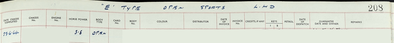

Normally, the door keys would be the same on each side. For a fee, you can contact Jaguar Heritage and ask for a photocopy of the build ledger (which shows the key numbers the car left the factory with). They are likely to ask you to verify your ownership of the car as well as asking you for the key numbers you have. They will redact that part of the ledger if the key numbers do not match what you supplied them with.
I did the above and now have a copy of the ledger to go alongside the "standard" JDHT heritage certificate. It is nice having something that validates that my car still has the original locks fitted to it.

#34 Re: Refurbishing door handles/locks
Post by paydase » Thu Feb 02, 2023 3:20 pm
Philk wrote:
Mon Apr 12, 2021 7:34 am
Hi Phil,
If you don't mind, could you please post a photo of the copy of the ledger that JDHT supplied you with (possibly redacting your key numbers) to see what kind of information they supply?
I would be interested to know what kind of info they deliver concerning the cars close to the one we own.
Serge
1964 (3.8) FHC
1961 OTS
Philk
Posts: 763
#35 Re: Refurbishing door handles/locks
Post by Philk » Thu Feb 02, 2023 3:49 pm
Fortunately, mine was at the top of the page so you can see the headings where information can be added under. Whilst I've blanked out my car's information, please note that some of these fields may be blank anyway given there is a dependency on information being passed back to Jaguar from the supplying dealer whom, in the case of LHD cars, would all be abroad. As such, information would be added to the build ledger in different handwriting/pen colours.
1964 S1 3.8 OTS
paydase
Posts: 696
Location: Belgium
#36 Re: Refurbishing door handles/locks
Post by paydase » Mon Feb 06, 2023 11:56 am
Thank you Phil.
So apparently they blank everything apart what concerns your own car, no possibility to see infos on the cars just before and just after.
Not surprising though...
