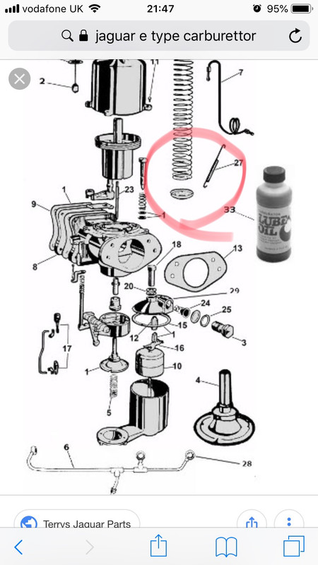

Hi Jeremy...anti skid washer?....never seen one before. ...just googled and only mention is for tapered spring on Burlan site but thats a plain looking washer ..Steve

#22 Re: S1 & 420G similarity
Post by Jeremy66 » Fri Jan 18, 2019 8:05 pm
Burlen don’t list or make them but they were in some HD8’s

Post by mgcjag » Sat Jan 19, 2019 8:54 am
Hi Jeremy..thanks for posting diagram showing skid washer....had a look and its shown in the Jag service manual and in the parts catalogue S1&S2 in the knowledge base.....iv had quite a few HD8s apart and rebuilt but have never see one before......theres always something to learn with an E type...cheers.....Steve

Post by christopher storey » Mon Jan 21, 2019 2:59 pm
Steve : I don't think that this washer is in fact an authentic part. I see that this diagram is in fact from Terry's which is some American aftermarket spares outfit . If it's not in the Burlen list, then in my book it's not authentic !

Post by mgcjag » Mon Jan 21, 2019 3:24 pm
Hi Christopher...its shown in the green Jaguar Service manual on the carb diagram...and its in the parts catalogue here in the knowledge base section for S1 & S2 cars....Steve

Post by MdR » Thu Jul 25, 2019 2:21 pm
Hi, a late reaction; but is this skid washer a crucial part of the carberator? In order to fine tune the 3 HD8's of a 4.2 engine?

Post by PeterCrespin » Fri Jul 26, 2019 8:24 am
Not essential really..It’s a simple brass stamping to keep the base of the big soggy spring concentric with the damper tube. I assume it prevents the base of the spring skidding sideways and the spring becoming fractionally less linear if it skews and rubs the casting, but most carbs either no longer have it or never did. I have one original part if someone wants to 3D print a few?

Post by Geoff Allam » Sat Jul 27, 2019 5:02 am
I have three that came with a mark ten set of carbs. Looking at them it looks to me like they lift up the springs about 1/4 inch which would create more spring tension and make the mixture slightly richer once the carb was off idle?
