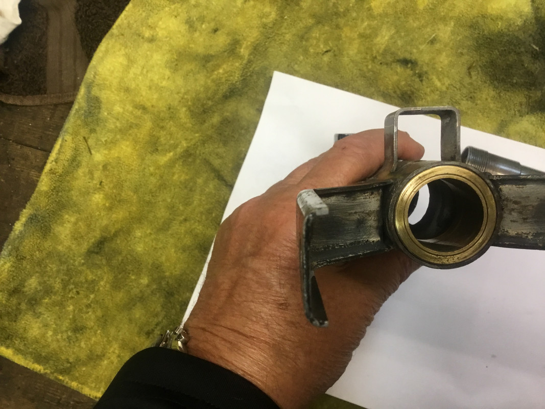

Just gone through all this, tried two sets of plastic bushes over 3 years, they would either bind or have excessive play and both sets squeaked.
Gave up in the end and had phosphor bronze bushes made and fitted. No issues since

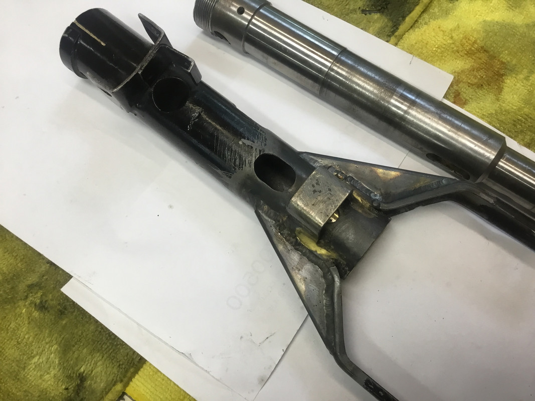

Point to note when I removed and stripped the column I found the the two lower legs were split and cracked!
I brazed these and braced the legs with box section.

Hi Andrew I deleted the comment about the metal bushes/horn in my post above.....Andrew didn't send me the Delrin I found a supplier here.. https://www.metals4u.co.uk/materials/pl ... cetal-tube also known as Acetal..Delrin is mentioned many times on forums for bearings.....the problem I had with the plastic bushes from the usuals was they didnt fit correctly anyway and the inner surface pealed off as in your photo....so thought this option would be better....we don't really need a precision fit here after all the original was just felt and a slight clearance fit is what I'm going for.....I'm making the bearings much longer 35mm than the plastic ones...Steve.....ps now done and super smooth steering column
