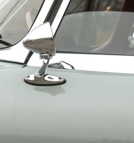

#23 Re: Best type of exterior mirrors
Correct, basics laws of reflection. The further the mirror is from the eye, the narrower the field of vision. Convex mirrors expand the field at the cost of smaller imsges. The last thing you want in a mirror miles away is a tiny image. Bonnet mount mirrors look nice if you put form over function, but as practical driving aids they are a poor choice. If you have to look round to be certain of the situation you might as well not have drilled the holes.peters3103 wrote: ↑Mon Nov 02, 2020 12:50 amI had twin, wing mounted bullet mirrors on my Mk2 and they were too far forward to be of any use.
The closer the mirror to your eyes, the bigger the field of view and the larger the image, pari passu. Hence door mirrors have been a legal requirement on new cars for ages and wing/bonnet mirrors don't pass muster.

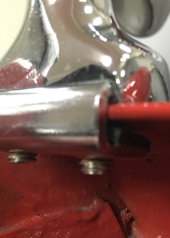

Hi Steve,
I picked up a mirror from Summit Racing which appears to be the exact same mirror you have.
I find i cannot mount it on the door edge and use pads inside or outside. Mount is too tight.
Dont really want to screw the set screws into the underside of the flange into the paint/metal or mount the metal face of the mirror to the outside of the door without some kind of pad.
Does your mirror have pads that fit between the sheet metal and mirror mount?

#27 Re: Best type of exterior mirrors
Layne,
just verified my mount has a rubber(?) pad insert. My door edge measures right at .100" along that edge.
Clamp opening on the mirror base is about 3/8" wide, without inserts. (pads on both sides)

#28 Re: Best type of exterior mirrors
Hi Steve
Yep, see the pad on bottom.
Pad on both sides or is it metal to paint on the top?
Can't seem to find room on either side for a pad on this one although it comes with a formed pad that is made for the top of mount, mirror to outside.

#29 Re: Best type of exterior mirrors
Edited my last post: Pads on both sides. As I recall I made both pads myself. Thin one on the top side, thicker on the bottom.
#30 Re: Best type of exterior mirrors
Thanks Steve, good info.
The mirror I got has a 1/4" opening, that would make the difference alright.
Got mine from Summit at same price, looked the same, I get stuff out of Reno in one day, and I had a free freight order to give to give them so I went with them. Oh well, I'm out $16. Maybe the mount will bend open more or I'll use it for something else.
I'll check with Speedway. Thanks for the link.
Layne

#31 Re: Best type of exterior mirrors
I looked at my top pad and it's very thin plastic. I believe I used one of my wife's ultra thin cutting boards.
Perhaps you could use something similar on both sides? A 1/4" opening should leave plenty of room for some type of material to minimize paint damage.

#32 Re: Best type of exterior mirrors
Also should note I eyeballed the clamp opening dimension, so 3/8" is not a direct measurement.
#33 Re: Best type of exterior mirrors
Thanks.
One way or the other the gap in my mirror will not allow any pads or shims to avoid metal contact top and bottom. We'll see what works out.

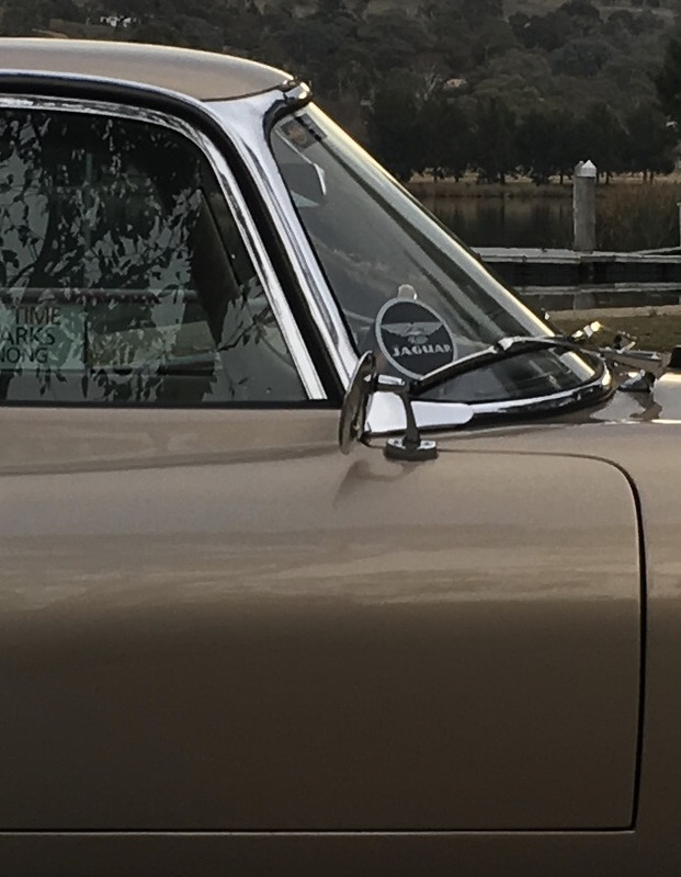

#35 Re: Best type of exterior mirrors

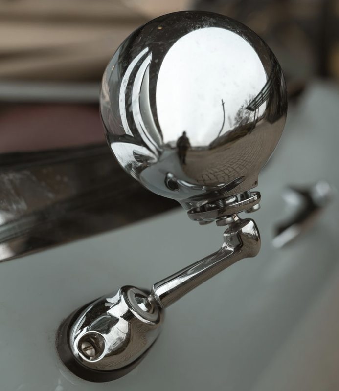

That is an unusual mirror, do you really want that style as many find the door pillar mirrors referred to by Heuer in post 11 are a very good option and save drilling holes in doors? I know from my own experience of fitting mirrors in the position you show that it can be very difficult to get the correct position.

#37 Re: Best type of exterior mirrors
Harry, I’ve not seen any mirrors like them on any E Type photos I’ve seen. Can I suggest they are one of the last items you need to find when rebuilding your car and to use the ones suggested above before looking for anything different. Have fun.
