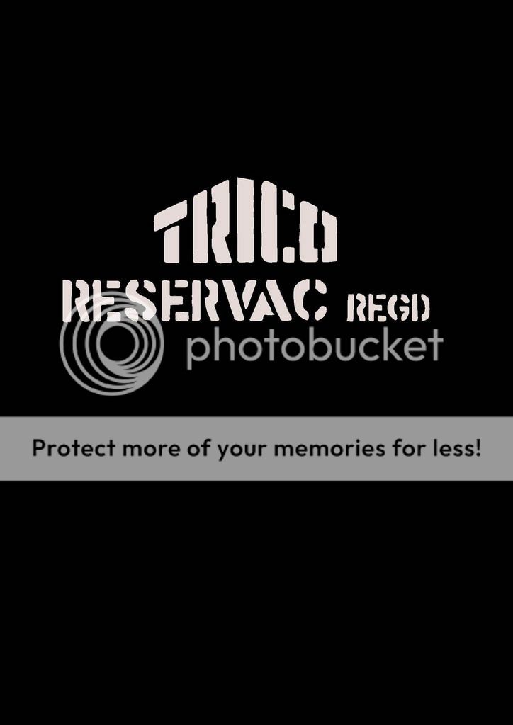

Thanks for making the file, I made a rough Illustrator trace and need to tune the anchor and handles.
My idea is to vinyl print the file, rip off the letters and apply the piece you usually throw away gently to the tank and paint.
Do not have a place to dump ai files but will put some effort into adjusting the outlines and post it online on a filedump service.
The trace in jpeg.. handles need tuned but it should be a little "rough in the edges" I suppose. (edit, inverted the image to be white on black)
Illustrator give full control over the points in the trace that make up the letters. eg the I in trico and other letters can be corrected. Maybe someone already have an ai or svf file that is good to use?
