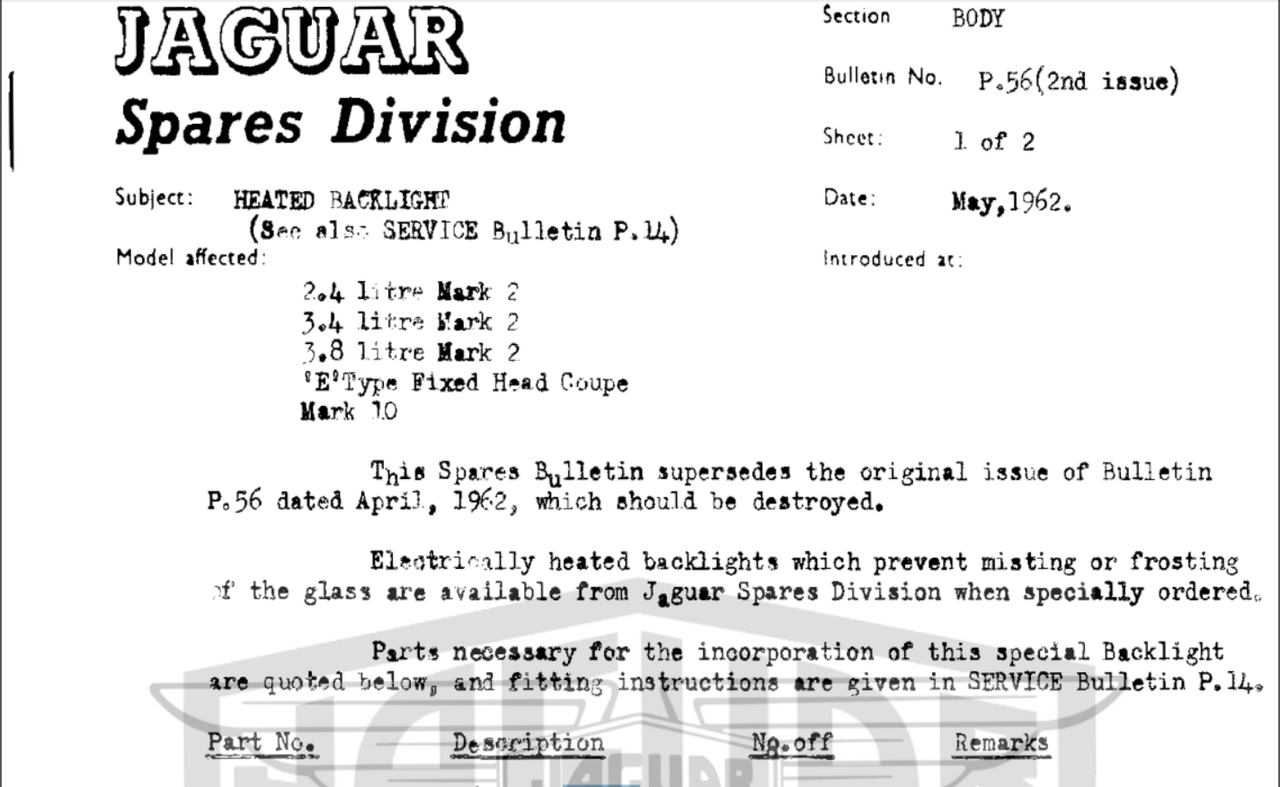

2. April/May '62, accodring to SPB P.56:
"Electrically heated backlight, which prevent misting or frosting of' the glass are available from Jaguar Spares Division when specially ordered:"
BD21942 BACKLIGHT(CLEAR GLASS)
BD22742 BACKLIGHT("SUNDYM"GLASS)

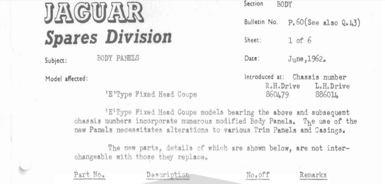

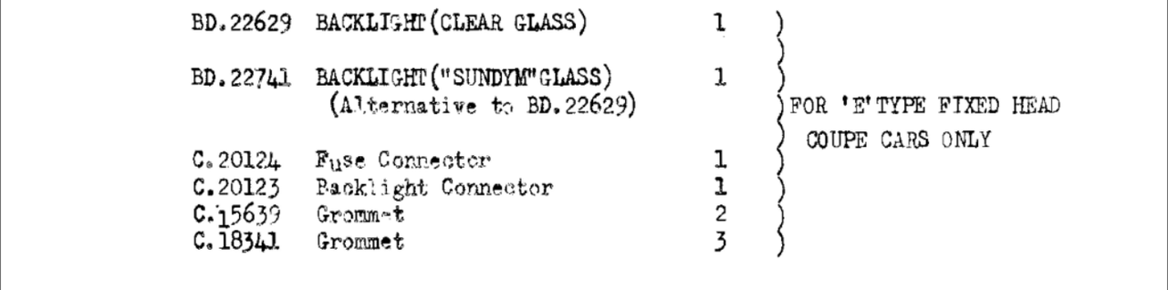

3. June '62, according to SPB P.60, starting from chassis 860479 and subs. & 886014 and subs.:
"'E1 type Fixed Head Coupe models bearing the above and subsequent chassis numbers incorporate numerous modified Body Panels. The use of the new Panel necessitate alterations to various Trim Panels and Casings."
This meant that since the boot lid was modified, the glass had to be modified, too, and the following new glass versions were to be used
BD19650 GLASS IN BOOT LID
BD22740 GLASS IN BOOT LID (CLEAR GLASS), heated
BD22744 GLASS IN BOOT LID ("SUNDYM" GLASS), heated

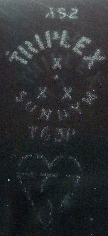

LOGOS
The SUNDYM glass had a special logo. Here is a sample from '62 S1 Chassis 888330 manufactured March 1963.
Logo dated from Q4 '62:
Although the logo is from Q4, I do not think it was different in Q2.
Starting from '63, logo changed to have TRIPLEX printed in a thicker font:

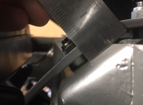

Distance Pieces, Spacer Collars, etc.
With great help from Ian Howe, I have put together a table with various spacers, distance pieces, etc. A lot of suppliers do not quite supply right dimensions or do not supply the part at all:
C2155 Distance piece for the C19890 Clip retaining sparking plug leads
C11583 Distance piece under dipstick retaining Clip, on Manifold nut.
C18307 Distance piece for dynamo adjusting link C18850 (late 3.8, From engine R1845 onwards)
C18283 Distance collar for the radiator rubber mounting pads
C8976 Distance collar for the header tank bracket rubber mounting pads
(Ian is 90% sure the taller collar is for the radiator.)
The rubber pad C8975 current supplied by the usual suppliers seems to be very tall for these distance collars as it compresses them way too much.
C16766 Distance Piece, under forward end of Tie Bars for the radiator
C15712 Upper Distance Piece, between Cowl and Tie Bars
BD541/9 Lower Distance Piece, between Cowl and brackets under Radiator Block
