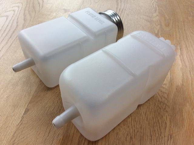

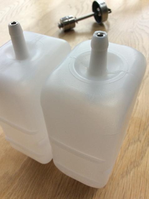

Hi Guys,
Sorry for the late post, but we’ve been away and not been able to take the following photos until our return.
Incidentally, on our recent trip away, we called into SNG on the 30th May to collect some parts and just caught the last of the Forum members before they departed after their tour and meeting there, so it was good to put some faces to the names.
Just to say that there are other suppliers of these brake and clutch reservoirs and having heard of leakage or splitting problems with reproduction reservoirs, as we regularly go out to the US West coast on one trip I brought back a couple of brake reservoirs and a clutch reservoir from XKs Unlimited in California.
These they state are now manufactured by them and they have taken steps to provide a “superior“ part with a moulded in reinforcing sleeve and internal filter, plus the brake reservoirs have stainless steel floats rather than the original cork and aluminium floats.
I post these photos purely to show the quality and construction and perhaps a noticeable larger taper to the attachment pipe moulding. They appear a very strong moulding and do not flex. Having not yet used these items, I cannot endorse them, but perhaps some of our US colleagues have and could comment if these have proved effective and not give rise to any moulding issues ?

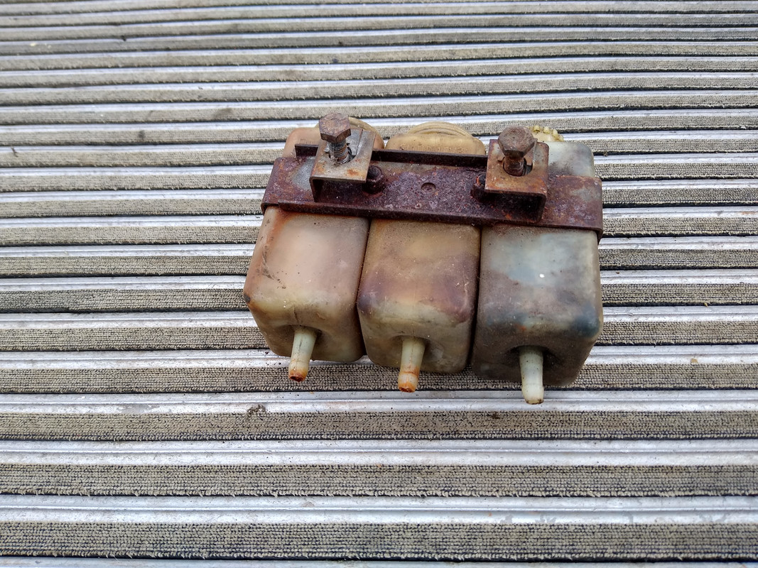

Came across these the other day.
It would be interesting to see how they stand up to being pressed back into service.
They are definitely made from a different material and wall thickness to what is currently on the car.

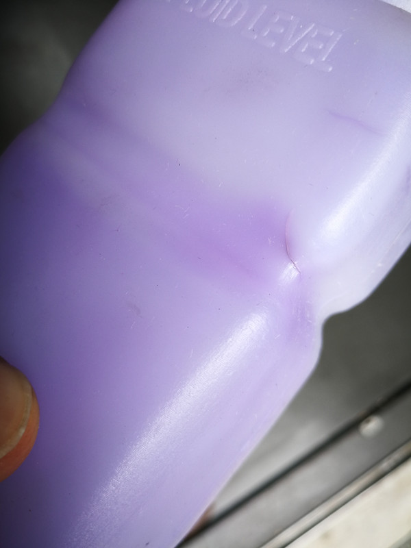

I'm resurrecting this thread as my nearside (single) reservoir bottle (square design) has started leaking. Not from the spigot at the bottom, but oozing out from under the bracket, so the front surface of the bottle is wet:
This was new from SNG about 3 years ago. Julian indicated that he was going to look into the long-standing issues with these bottles, but I haven't seen if there have been any developments?
The bottle has spewed out about half its contents so far. Fortunately I'm using DOT5 silicone so the paintwork is all ok. Thank heaven I followed Angus's advice on that point.
Julian, if you read this, grateful for any update you can offer.

Here's the failed bottle. You can see the split half way up in this photo, nowhere near any seam or spigot. I can categorically say that the bottle was not subjected to pressure or stress when I fitted it (I knew they were delicate so I handled them with great care).
Angus has come to my rescue by supplying a set of replacement (original) bottles, for which I'm extremely grateful.
And another issue on this product (not dangerous, just irritating) is the level indicator. The sticking-up pin is approx 4mm too long, so if the rubber cap is properly fitted it pushes the float down and turns on the warning light. So either the pin needs cutting down or the cap needs a higher dome.
Julian, forgive me if I've missed an update on this elsewhere. Otherwise, could you let us know where it's at? Thanks!
