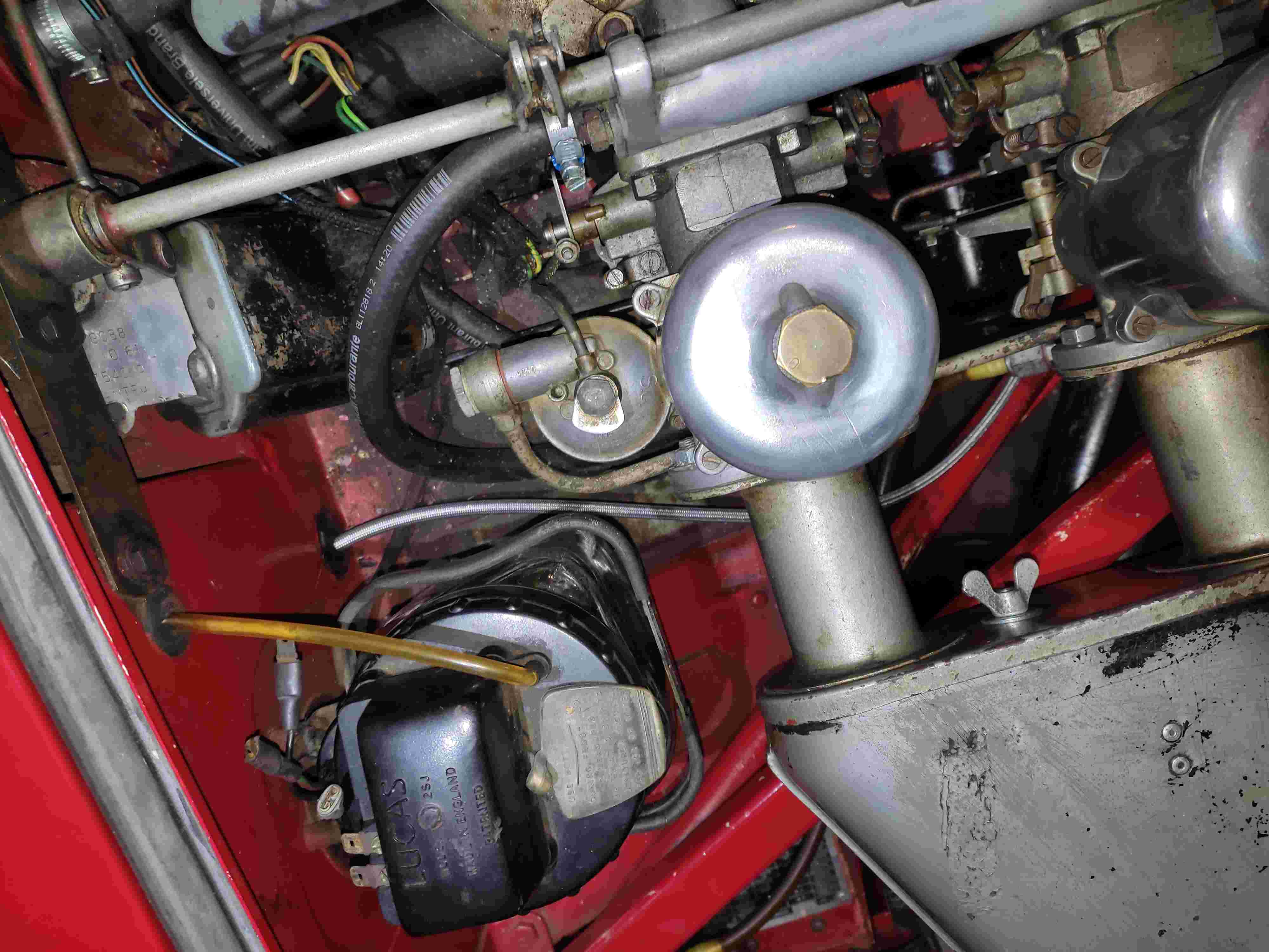

Here is the path I chose after looking at various options.
Firstly, I preferred connecting the gauge directly on the oil rail close to the filter housing, instead of installing a tee inbetween the electrical sender and the filter housing.
Looked to me simpler in terms of fittings:
Secondly I routed the braided hose through an existing hole in the front shield (just had to cut open an existing rubber plug):
