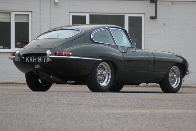

Post by politeperson » Sat Feb 05, 2022 6:08 pm
The Blockleys are well priced and drive very well. Even compared to XWXs.
205s below.
