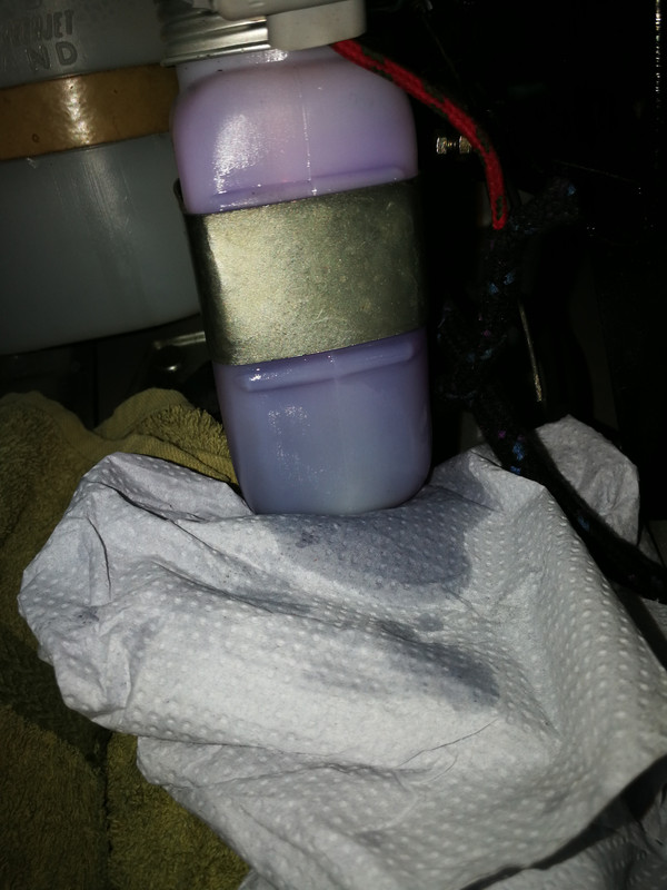

Jeremy, looking at the photos you've supplied it appears your bottle has failed due to some sort of interaction with the metal mounting bracket. I'd suggest you need to look at both items together as your problem may be a poorly made or overtightened bracket not a poorly made bottle.Jeremy wrote: ↑Sun Jun 07, 2020 4:03 pmI'm resurrecting this thread as my nearside (single) reservoir bottle (square design) has started leaking. Not from the spigot at the bottom, but oozing out from under the bracket, so the front surface of the bottle is wet:
This was new from SNG about 3 years ago. Julian indicated that he was going to look into the long-standing issues with these bottles, but I haven't seen if there have been any developments?
The bottle has spewed out about half its contents so far. Fortunately I'm using DOT5 silicone so the paintwork is all ok. Thank heaven I followed Angus's advice on that point.
Julian, if you read this, grateful for any update you can offer.

Yes John, that did occur to me....bracket also supplied by SNGB. Hard to overtighten it, as it's one bolt either done up or loose. But the shape of the bracket itself may not be perfect as you say.

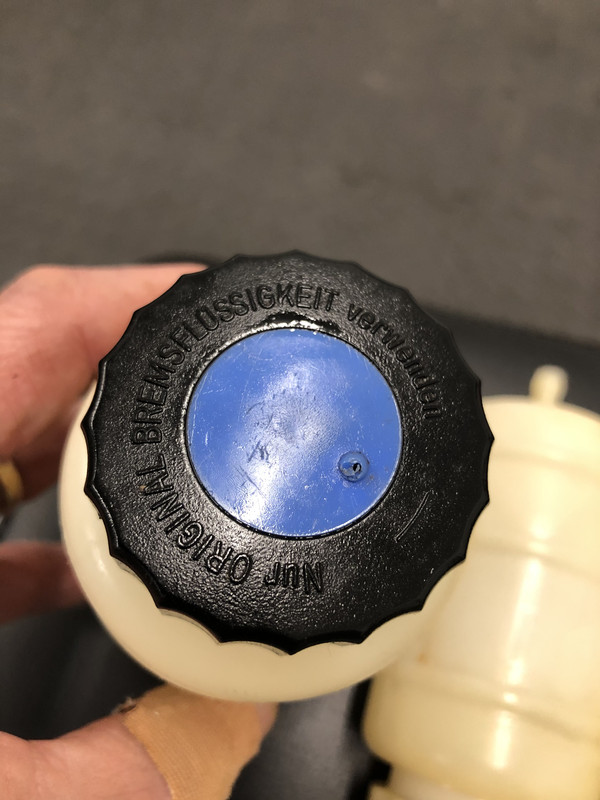

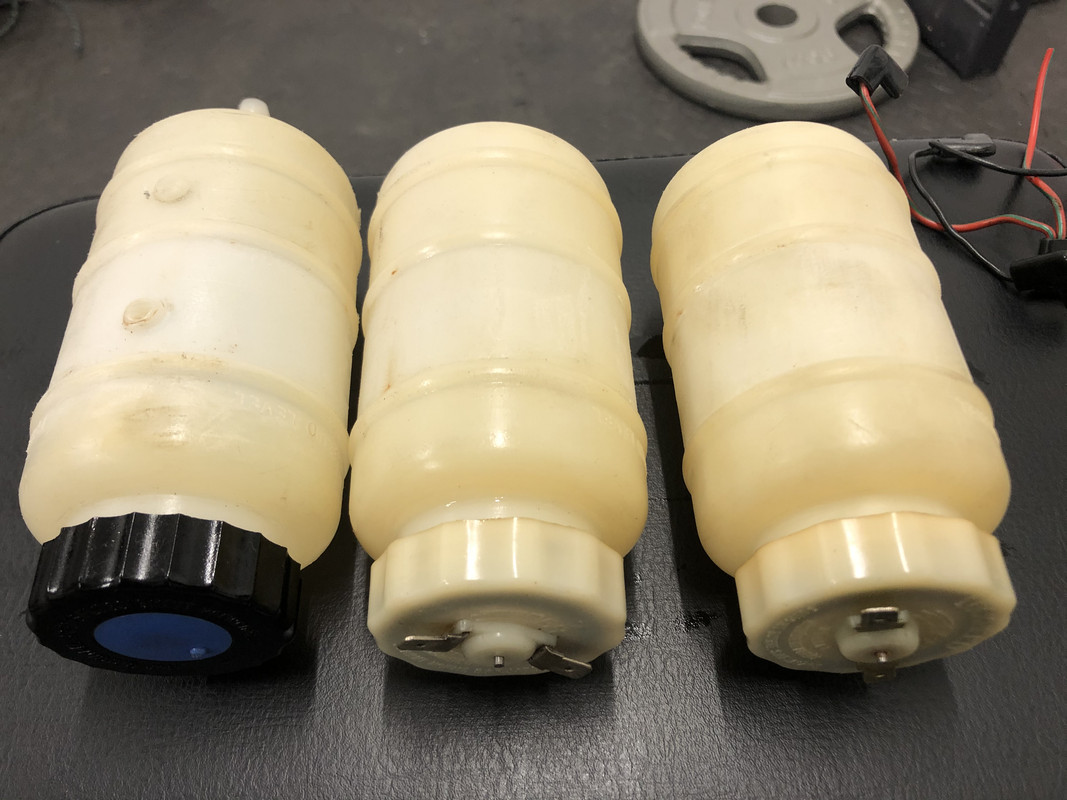

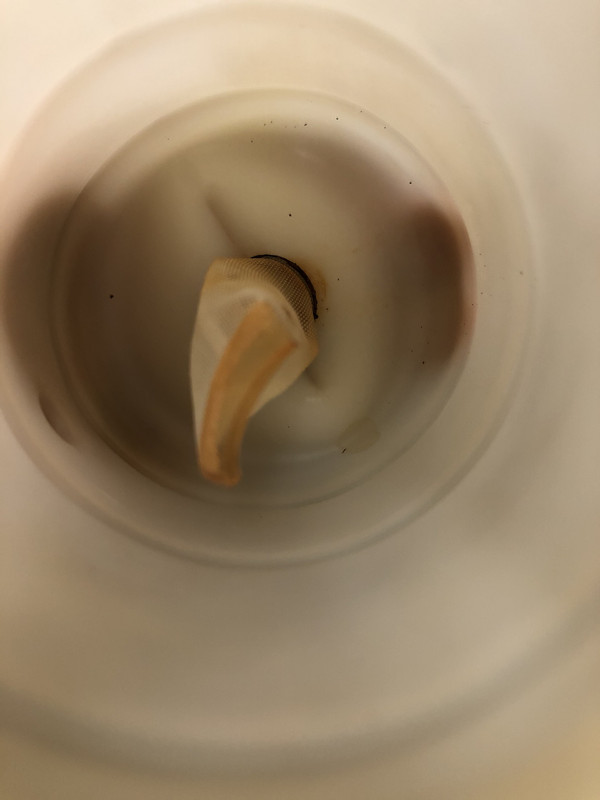

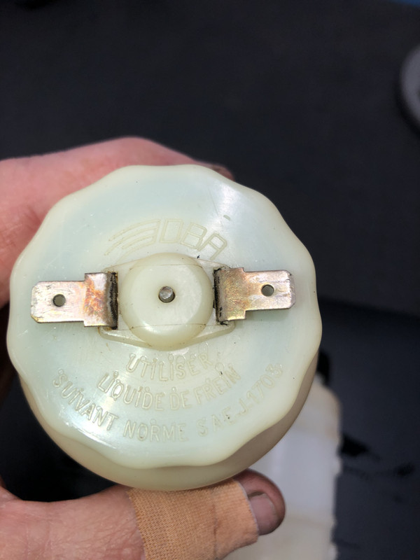

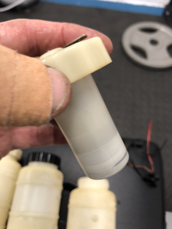

Just to hijack this topic
I have 3 original bottles for my March 62 OTS (850456)that I’ve cleaned/bleached as much as possible
They are in good shape..no cracks apparent after filling them with DOT5 and leaving for a week
The caps vary :
1. Clutch has German writing on top and is plastic and blac
2. Brakes also both plastic(no metal) one has lockheed and DBA, the other has only DBA, both have French script!
My question is about whether to replace the caps with new?
SNG B spear to have appropriate ones for my chassis number in plastic and metal
What do people think?
I’m inclined towards replacing the caps to look more correct and hopefully will have good functioning warning connections and floats??

Just to say i am aware of this thread. As far as i can see, the resurrection of this is down to the bottle that has split in an unusual place - away from the seam and the pipe at the base from a purchase a few years back.
We made a new batch of these in 2019 and are generally supplying complete with hose already fitted as there was a suspicion that some bottles were being damaged during fitment. I am not aware of any failures or issues with the most recent batch produced.

Thanks a lot Julian - "bullet-proof" sounds like a great design spec. And while you're at it, if you can make sure the brackets aren't subjecting the bottles to unhelpful stress or compression, even better. Looking forward to hearing more.
