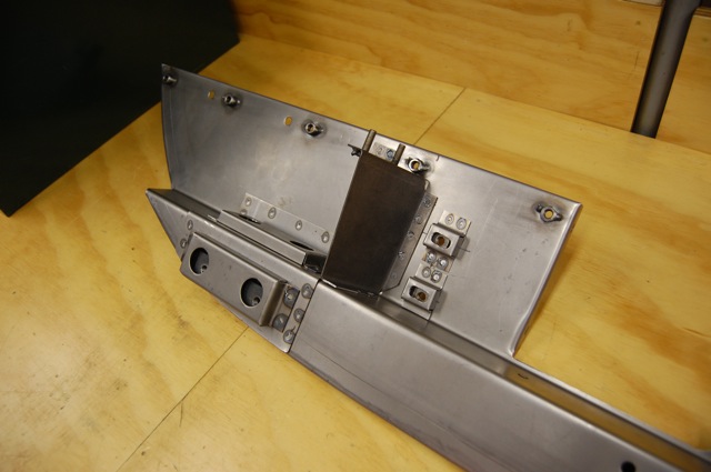

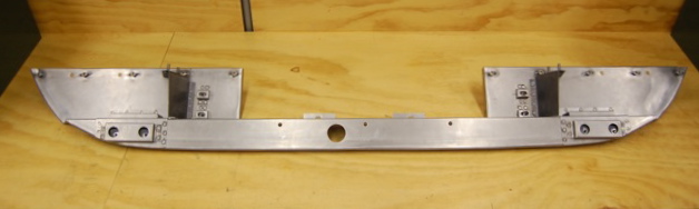

First port of call would be Hustons - speak to Andy as he will tell you if they are available anywhere in the UK. Failing that I would speak to Chuck at Monocoque Metalworks in the US as they have them:

This might be of help, you can see the 2 horn brackets:

These are very helpful - thank you.
