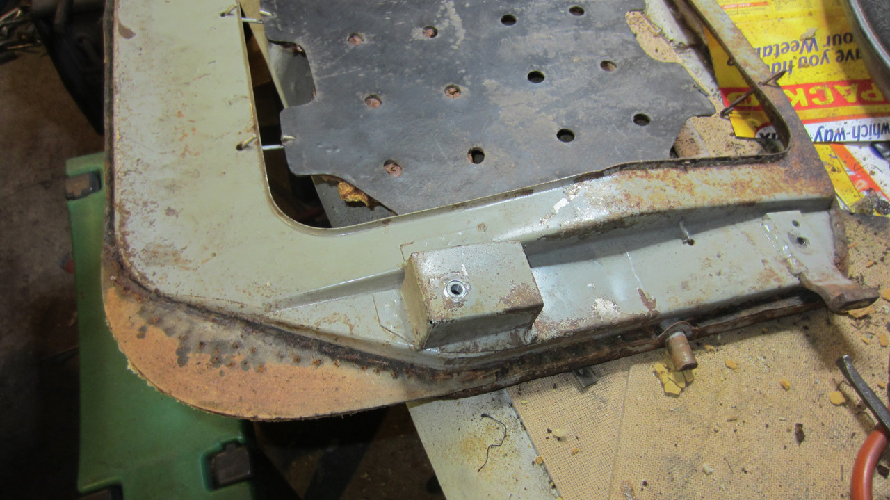

#4 Re: S1 Seats
Hi Steve,
I could be wrong, but my understanding is that the seat frames in the 2+2 are the same as the FHC; the trim is different however.
The frames are not sided, but there is a piece of hardboard trimming to support the foam on the underside of the seat base that makes it sided.
Note the 1.5 and Series Two seat frames are not the same as the Series One.

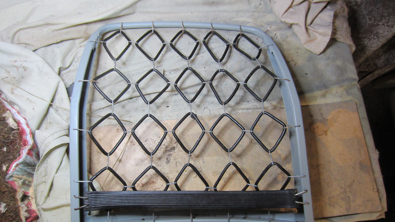

#5 Re: S1 Seats

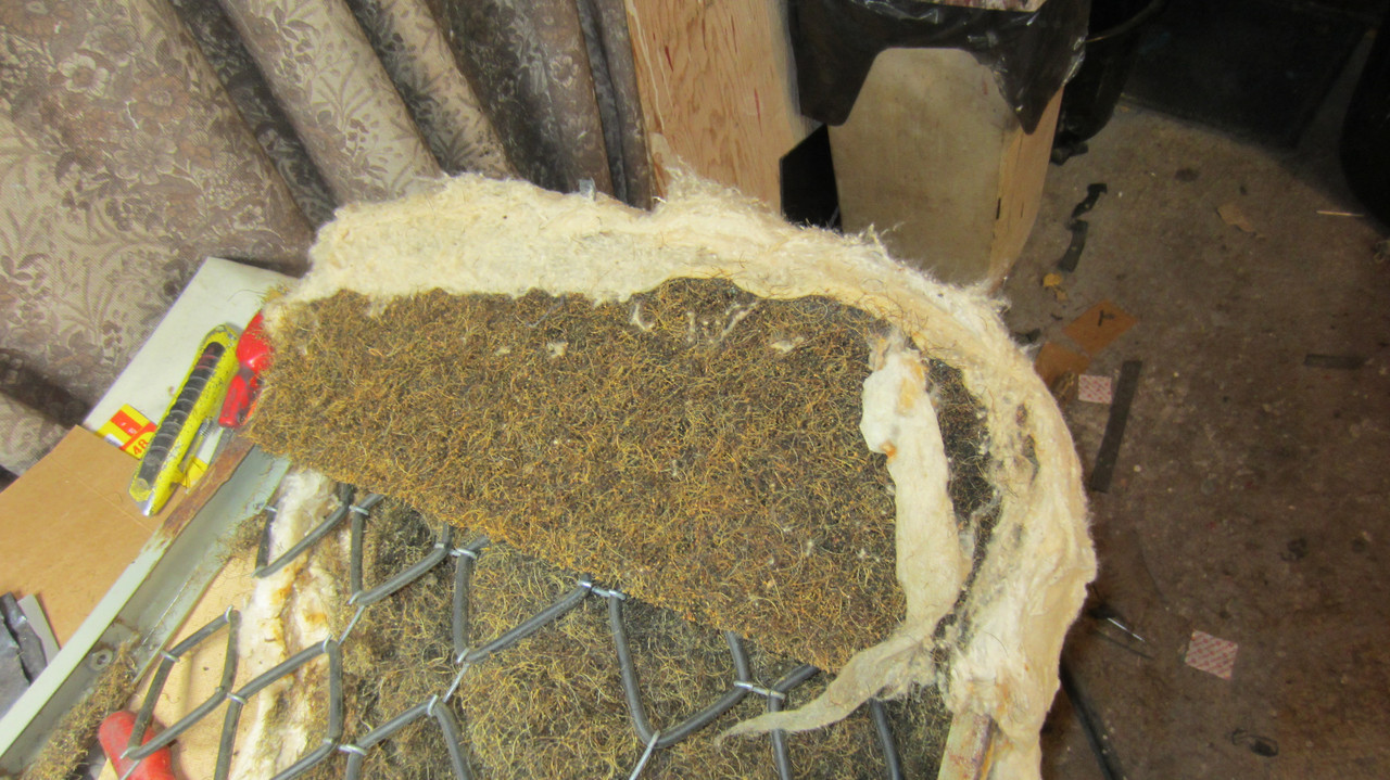

Wooo hoooo Thats just the info I was looking for Paul .. And the photos will be a great help too! Can I be cheeky and ask if you have photos of the backrest as well, I am assuming that they are constructed using some sort of sterling board? as opposed to a metal frame.
Edit,k I just looked properly at the bottom photo, is that the backrest?

#6 Re: S1 Seats
Hi Steve.....as i see you are looking for a seat then be aware that the reclining mechanism are handed and there are different hinges so have a good look at the one you already have...the seats also mount onto runners...Steve
#7 Re: S1 Seats

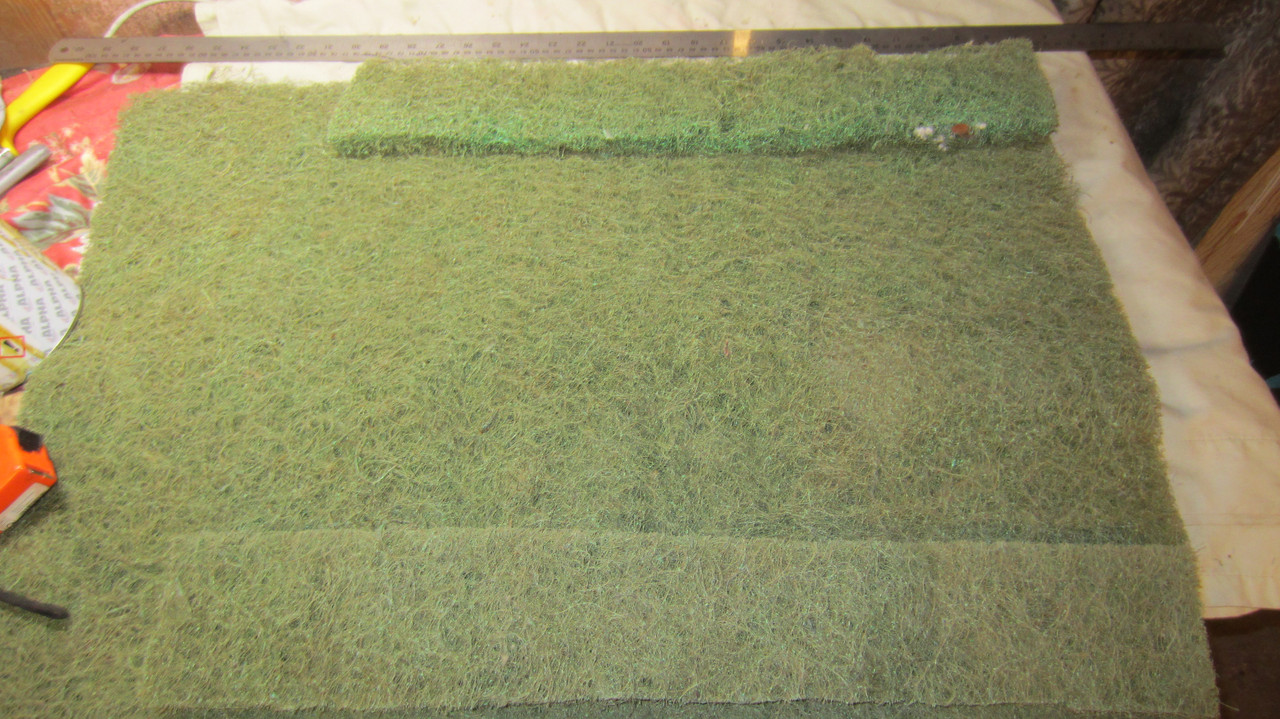

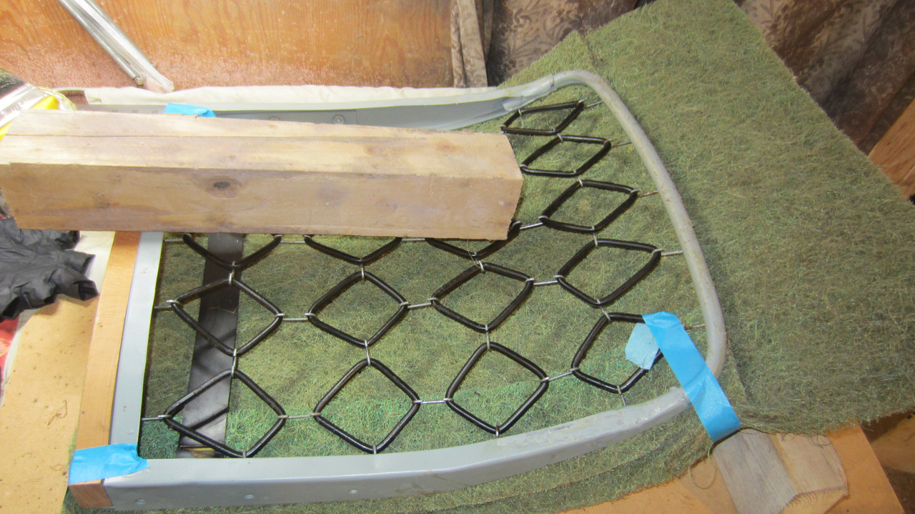

Yes the bottom photo is the backrest.
The backrest is as you see it; no boards. The rubber rings are the support for horsehair, which covers the rubber rings and is folded over at the top.
There are two further pieces added to the outer part of the front to create a curved effect.
Over the edge is some wadding to pad it out where necessary.
By the way, I had trouble getting enough clearence on the passenger side by the centre console on mine, but I am assured they are not sided.
#8 Re: S1 Seats
Hi Steve,
There is no reclining mechanism as such on the Series One, but it does have rising blocks to change the angle of the seat back.

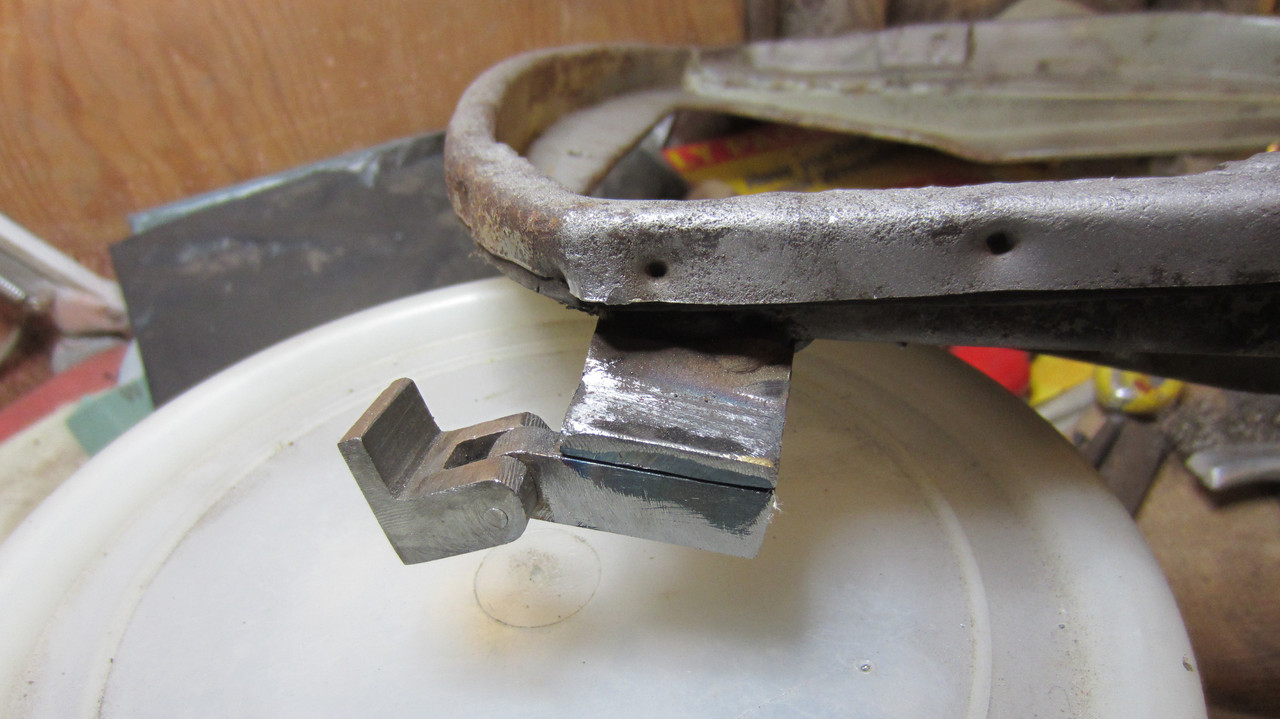

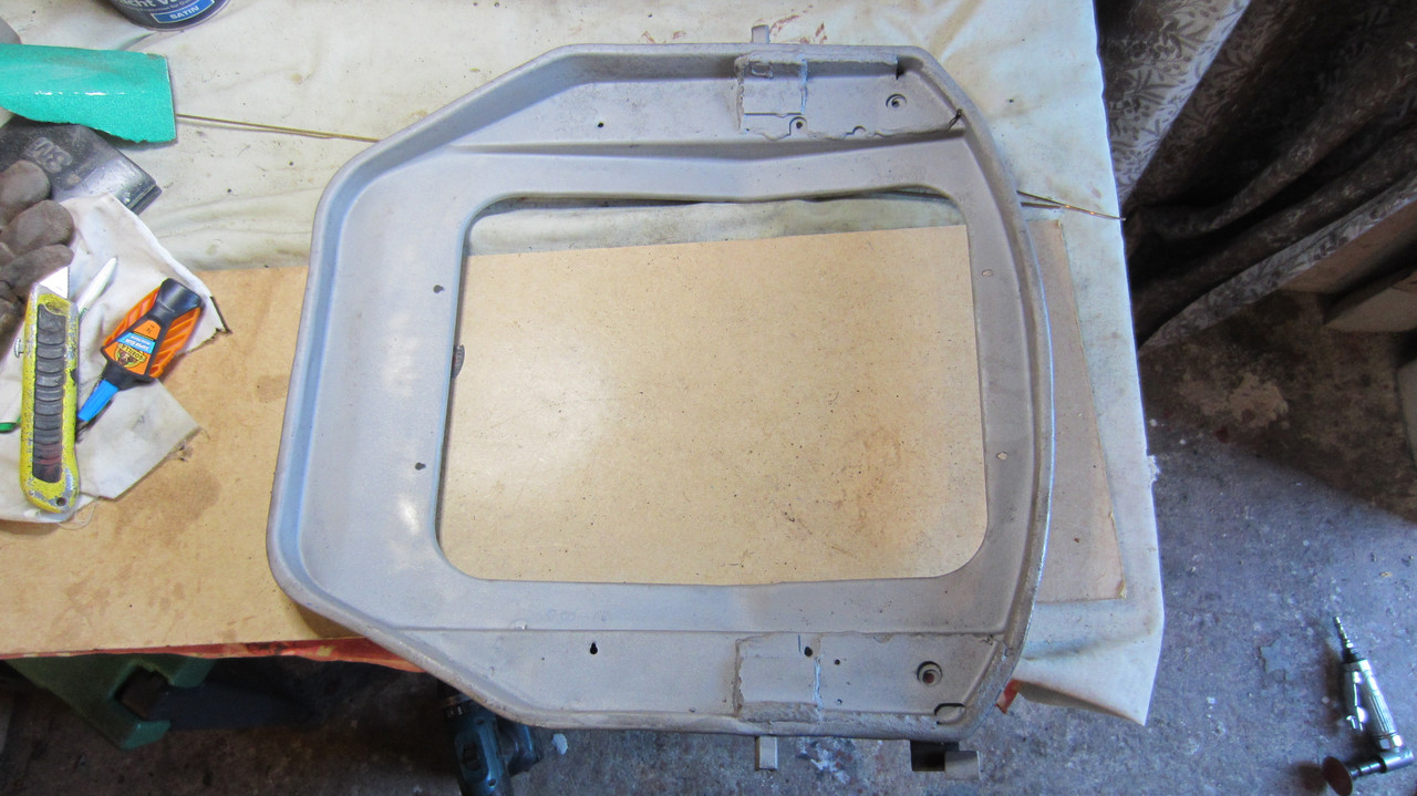

#10 Re: S1 Seats
Well we managed to get hold of another passenger seat complete with the frame. bit rough but we should be able to sort it and get it into the drivers side without much hassle, still looking for an age related drivers seat base cover or even a piece of any make/model material that I could cut and sew into the cover. From what Barrie has said, we have all the bits and pieces to put the trim back in, I can't remember but, when we stripped it down, everything was saved and boxed right down to the self tappers! We both have a few other things to do at the moment, but should start working early December (Also after a garage sort out)

#12 Re: S1 Seats
Quick update on the seats.
Converted the 2nd passenger seat into a drivers seat, sewn in new panels on the base and had a very quick wipe over with restorer, re-newed the back of the backrests to match and very pleased how they look now. The side chrome or should I say rusty seat hinges will soon be away at the chromers. Doors are in the process of being built up, vinyl door tops re-covered, going to see how the doors fit before I re-cover the panels as I have read somewhere that they can be a tight fit to the sill flange area. (See my question re door locks)
