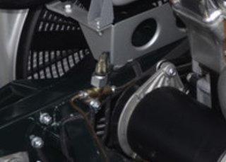

Where does the brake light hydraulic switch reside? is it on the picture frame?

Hydraulic switch is on the picture frame...just follow a brake line you will find it....only 9v....then you must have a high resistance joint somewhere.. volt drop...Steve
#5 Re: Weird electrical issue
Stock switch is On the front brake circuit. Follow the brake line from the master cylinder forward and you will find a Tee joint just below the header tank support. From there line to go each brake called and the top of the Tee has the pressure switch. Id just replace with new and see if it cures the issue. SNGB sell better quality switches than standard intermotor rubbish that seem to work. That will probably cure the issue. It's a simple job also to wire a relay so the switch operates the relay and the relay deals with the higher load for the bulbs but start by replacing the pressure switch. With the new one to hand you can do a quick unscrew and screw up and probably won't need to bleed the front brake at all...

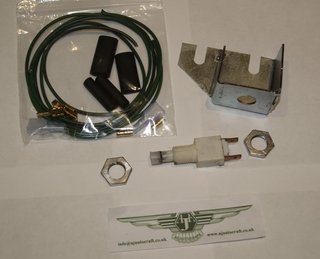

This kit looks more substantial than some of the weaker offerings around:
Part No. C16062MODE
http://www.ajautocraft.co.uk/partsWithPic.htm

Once I locate the switch.....and I did, it is in a very awkward location on mine just under the bottom hose of the radiator, there is just enough reach it to disconnect the wires, not going to bother with it and go straight for a mechanical upgrade.
