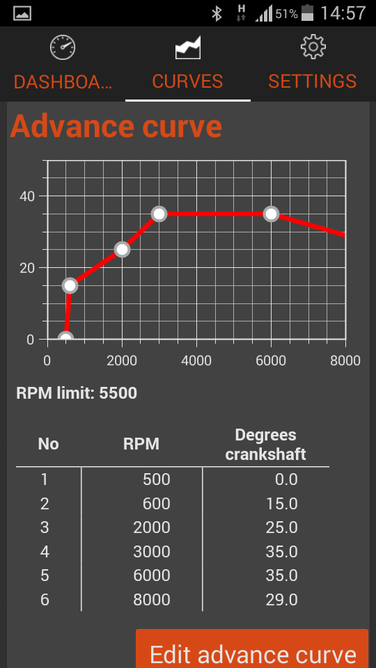

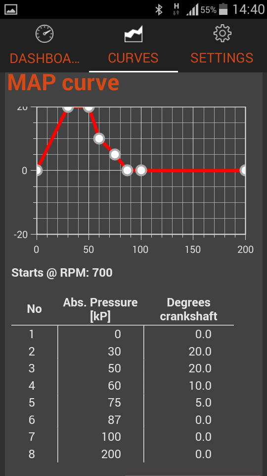

I attach the two curves she is running with at the moment but NOTE: This is running at 1450m AMSL (4750'), so I would expect lesser figures on the centrifugal advance curve where the car is closer to sea level. MAP advance might be very similar. These curves are thumb sucked by moi, and i'm sure one can do even better by tuning on a dyno.
This is the centrifugal advance curve. Note the upwards kink at 2000rpm.
This is the vacuum advance curve. I have found with most of my EFI projects that engines with lower compression ratios are highly tolerant of "aggressive" vacuum advance, which is in part why I have this shape.
