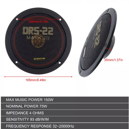

#15 Re: Original S1 Slim Console Speakers Wanted!
Post by etype_F57 » Sun May 02, 2021 7:31 am
mtnjag
Posts: 588
#16 Re: Original S1 Slim Console Speakers Wanted!
Post by mtnjag » Sun May 02, 2021 12:09 pm
Wow, incredibly cheap. Hard to believe the frequency response spec. Aren't they too big a diameter for you?
