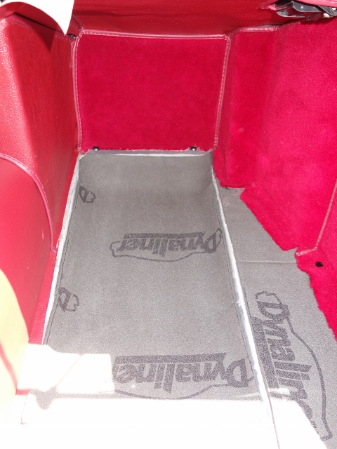

Hi, sorry I don’t know your name,
Have a look through Chris Vine a member on heres blog at the trimming section.
http://etype.chrisvine.com/category/reb ... yfittings/
Here’s one of many very useful pics.
There is also loads of info on how to fit and in which order the various trim panels.
