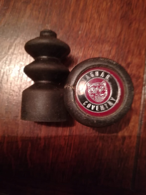

Thank you for your insight everyone, I have tracked down the knob that 'apparently' came fitted to the car when it was bought by my father in '65 from dealership in Park Lane London (sorry about image quality). That's as far as he can remember, anyway. I have always had my doubts and as a child, remember more of a checkerboard pattern on leather knob as mentioned by Peter, but I'm not sure either.
I have bought a standard replacement from SNG Barratt for about £20, it looks like the original, but not sure how it will weigh.

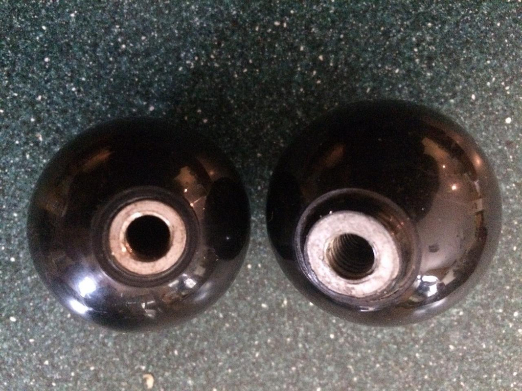

I've had a lot through my hands with selling gearboxes and never seen a brass one. Not saying they don't exist but it'd be an odd choice for an inexpensive non-visible, non-corroding, non-electrical non-precision piece (whereas pot metal, steel or cast iron would not be). I did find something interesting though.
These two (I usually have a couple more) are repro left and original right. The OEM is larger and weighs half a pound/8 oz, where the smaller one weighs 5 oz. To my surprise, however, the heavy OEM is pot metal (non-ferrous) whereas the repro is the magnetic one. I guess it's easier to CNC a mild steel sphere these days than to tool up for moulds? The difference in size and weight i s very notable in the hand. I'd expect that some who spend a decent chunk of cash to 'upgrade' from a wood or leather knob to a repro might be underwhelmed by the modest difference in gearchange feel. Just goes to show you should never throw old kit away until you're happy with the replacement.

Ahh, I assumed the weight came from brass, never really bothered to check. On the other hand brass is non magnetic and I would have thought pot metal would not have that much weight. Interesting.

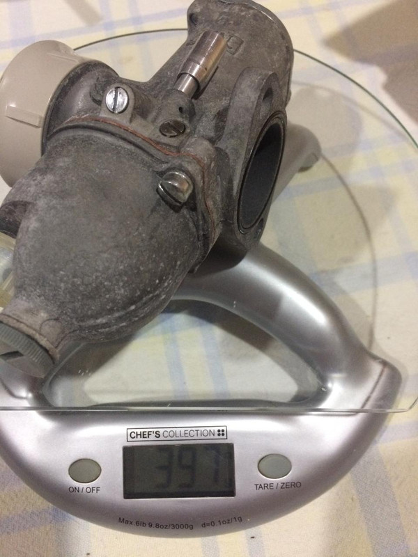

Some of the zinc alloys are heavy. The weights on pool vacuums, for example.
Coincidentally , today I corresponded with the Amal people at Burlens, asking the weight of their 32mm pot metal carbs. which they said are 1100 g, apparently. The two ex-work BSA ones I have are nearly 70% lighter, made as never-sold-to-the-public magnesium versions:

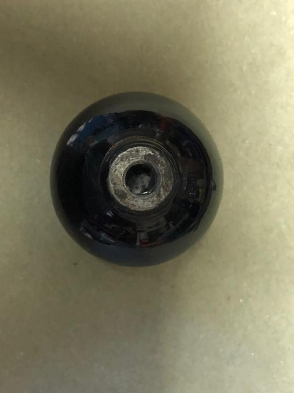

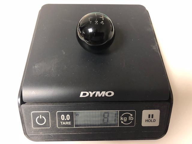

Hello All
As far as I'm aware, an original shift knob measures approximately 1.655"ish in diameter, weighs approximately 8.1 oz and the core is non-magnetic.
Hope this helps.

Non magnetic, rather than non-metallic, but yes, I agree with all parameters. I said 8 oz to round down - it was 8.1 oz same as yours.
