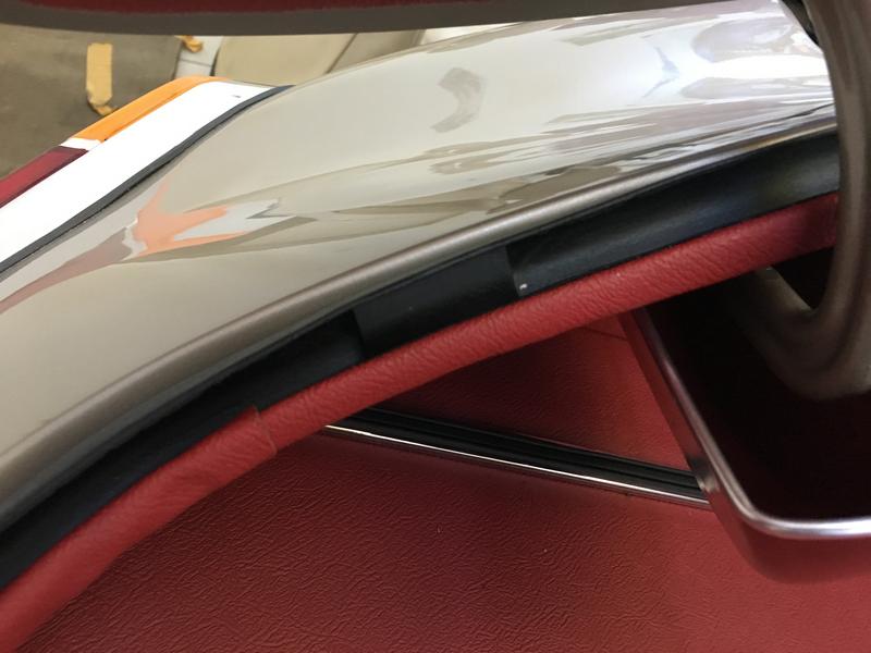

I have also reused the old one, which is black. This is a picture of the edge trimmed in leather (not my E).
Klaus
