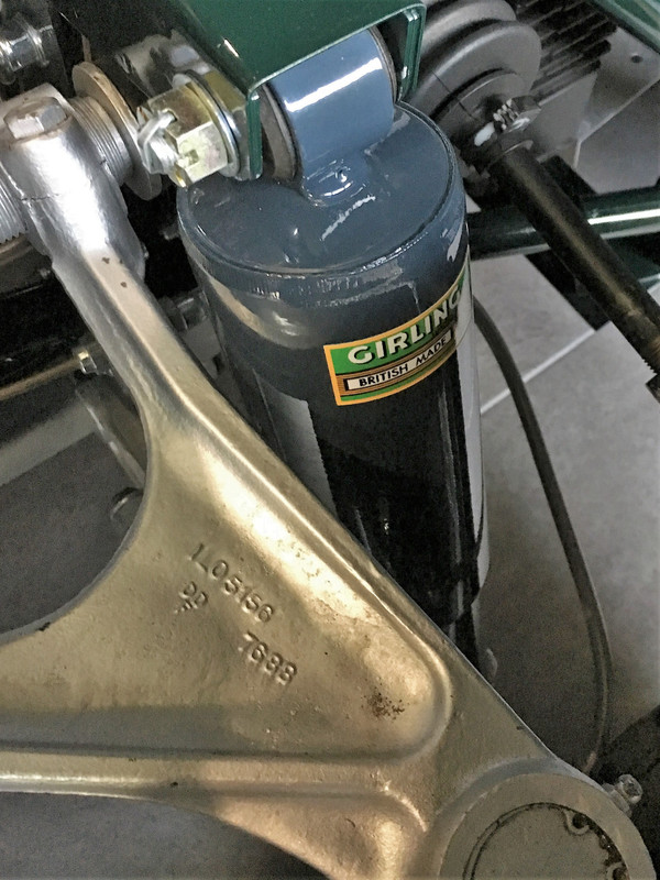

This is one of mine in BS633 with the Girling Decal in placeJeremy wrote: ↑Wed Dec 12, 2018 11:13 amHi Robbie, this has been well covered here. Factory fit and elsewhere. David (Heuer) has given chapter and verse on it. I resprayed my black Boges with BS 633 (RAF blue-grey) to imitate the original Girlings, although yours being very early may have been something else.

Thanks for the photo...I’ll get my paint man to match it
Where did you find the decals?

http://www.classicrepro.co.uk/Othermarques.htm Part No. ST429 (three-quarters down the page)
