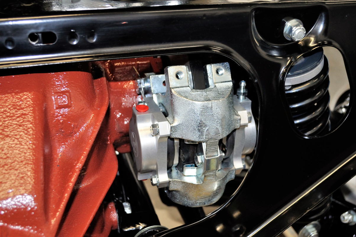

Philk
Posts: 764
#20 Re: Brakes upgrade
Post by Philk » Fri Jan 25, 2019 4:42 pm
Coopercraft rears being fitted to my car as part of an IRS overhaul we're doing at the moment...
