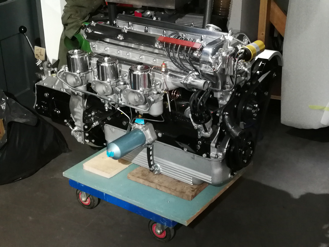

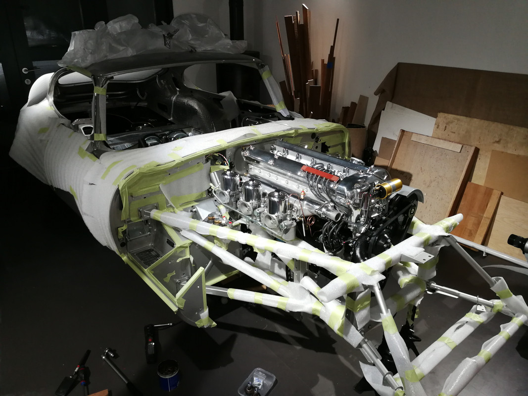

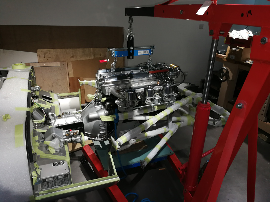

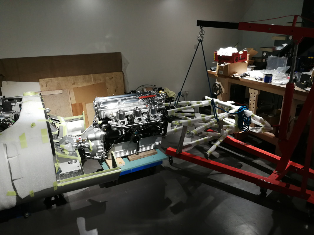

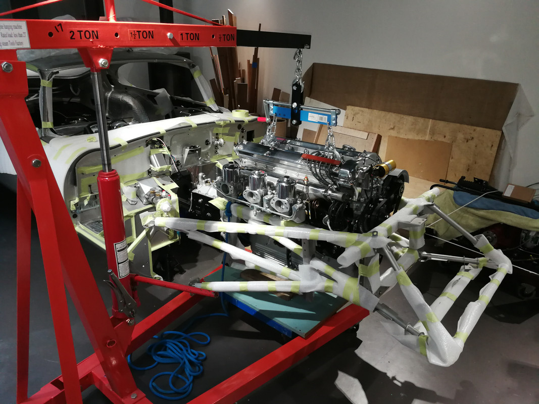

Building the frames around the engine is exactly what I plan to do...

#5 Re: Build engine frames around the engine?
Flippin ‘eck Jeremy, that engine looks good!
Almost a shame to put it back!
