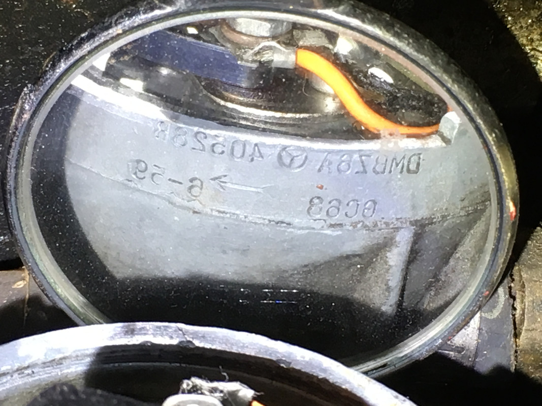

Hello everyone
wondering if you can help ?
havng recently purchased a 1961 car (875425) I am courious of the distributor identificatiom
the number/lettters on the body are DMBZ8A - 40528B - GC68 - 6-59
So I assume the part was manufactured in 1959 - so my question is, is this the original distributor
It strikes me as odd that a 1959 item would be fitted to a 61 car - maybe this distributor came from a XK150 or similar engine ???
Any ideas appreciated
thanks
Tony

40528A/B DMBZ6A 1956-59 Jaguar 2.4 Ltr Mk 2 8:1 CR
The correct one for your car is probably 40617A/D which you can pay a fortune for on EBay.
I've emailled you the ultimate in nerdery; the list of all Lucas dizzies by number. You can compare the two and see how they differ.

Send yours to the distributor doctor Martin Jay, he will rebuild it to correct spec incl the lettering/ numbers
