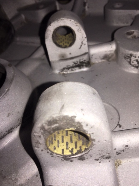

Hi!
dismantling my clutch (and gearbox) I discovered that the 2 brackets holding the fork shaft are equiped with sort of needle bearings:
I can't find them in the documents.
Do you have any idea about their references, so that I can purchase 2 of those and replace my originals?
Thanks in advance.
Philippe-J
Posts: 9179
#2 Re: Needle bearing for clutch fork shaft?
Post by mgcjag » Sat Aug 16, 2025 12:03 pm
C10025...they are bushes not needle bearings...Steve..ps you may have to ream the inside to fit your shaft if you replace them

#4 Re: Needle bearing for clutch fork shaft?
Post by rfs1957 » Sat Aug 16, 2025 7:28 pm
Philippe, your case looks like it has been bead-blasted, and if your bushings are indeed of a sintered semi-porous materiel then you need to be very careful that the beads (and their inevitable associated powder) have not inveigled (good word, beat that in French) their way into the stuff, as anything that remains will be highly abrasive on the shaft. Lots of cleaning in perspective.

#5 Re: Needle bearing for clutch fork shaft?
Post by Philippe-J. » Sun Aug 17, 2025 7:11 am
Good point Rory. Yes I did bead blasted the interior of the casing, as it was all covered with thick dirt.
So yes lots of cleaning is in order. Your remark is another reason for changing the bushes, isn't it?
BTW, do you agree with the idea of painting this interior with that orange "engine interior" paint, so as to avoid porous aspect, and consequences, of the alloy?

Philippe-J
Posts: 9179
#7 Re: Needle bearing for clutch fork shaft?
Post by mgcjag » Sun Aug 17, 2025 6:03 pm
You got blast media in the gearbox?... there are lots of needle roller bearings in there....I think that a total strip down is the only way clean it all out....Steve

Post by angelw » Mon Aug 18, 2025 1:53 am
Hello Philippe,
For future reference, if you want to inhibit the ingress of blasting media, of any bore like feature, seal it with Plasticine. One may think that such soft material would be ripped out in quick fashion by the blasting media, but no, you can direct the media blast directly on the Plasticine for some considerable time, and it will remain unscathed.
When you have a relatively soft material, of the bearing, and the relative hard material of the steel shaft, you have in affect, the making of a lap. In a lapping operation, you have a soft and hard component, where the hard material part is the component to be sized by lapping. The abrasive embeds in the soft material and wears the hard material that doesn't retain the abrasive. Accordingly, if abrasive material contaminates the bearings, it will embed in the bearing surface and wear the shaft in quick order.
As a beside, there is lapping media that can be used in an assembly, where it is abrasive for a finite amount of time. Accordingly, it can be added to the assembly to be lapped with no requirement to dismantle and thoroughly clean the component parts after lapping.
