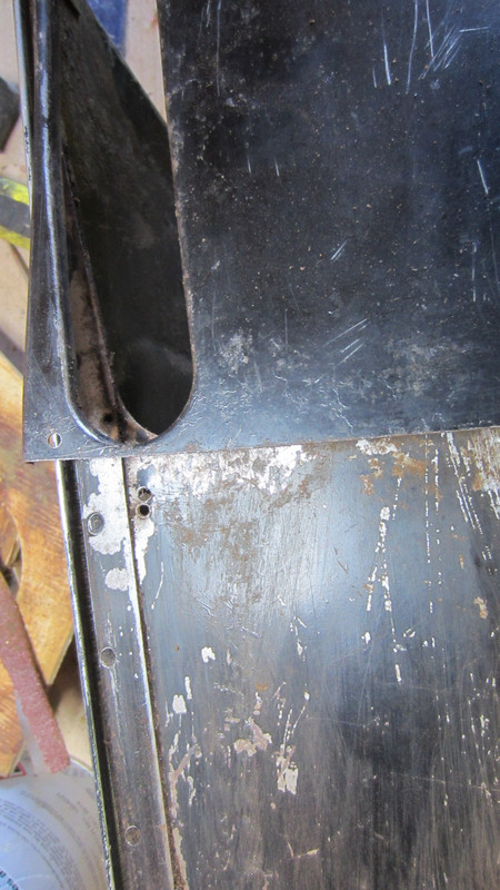

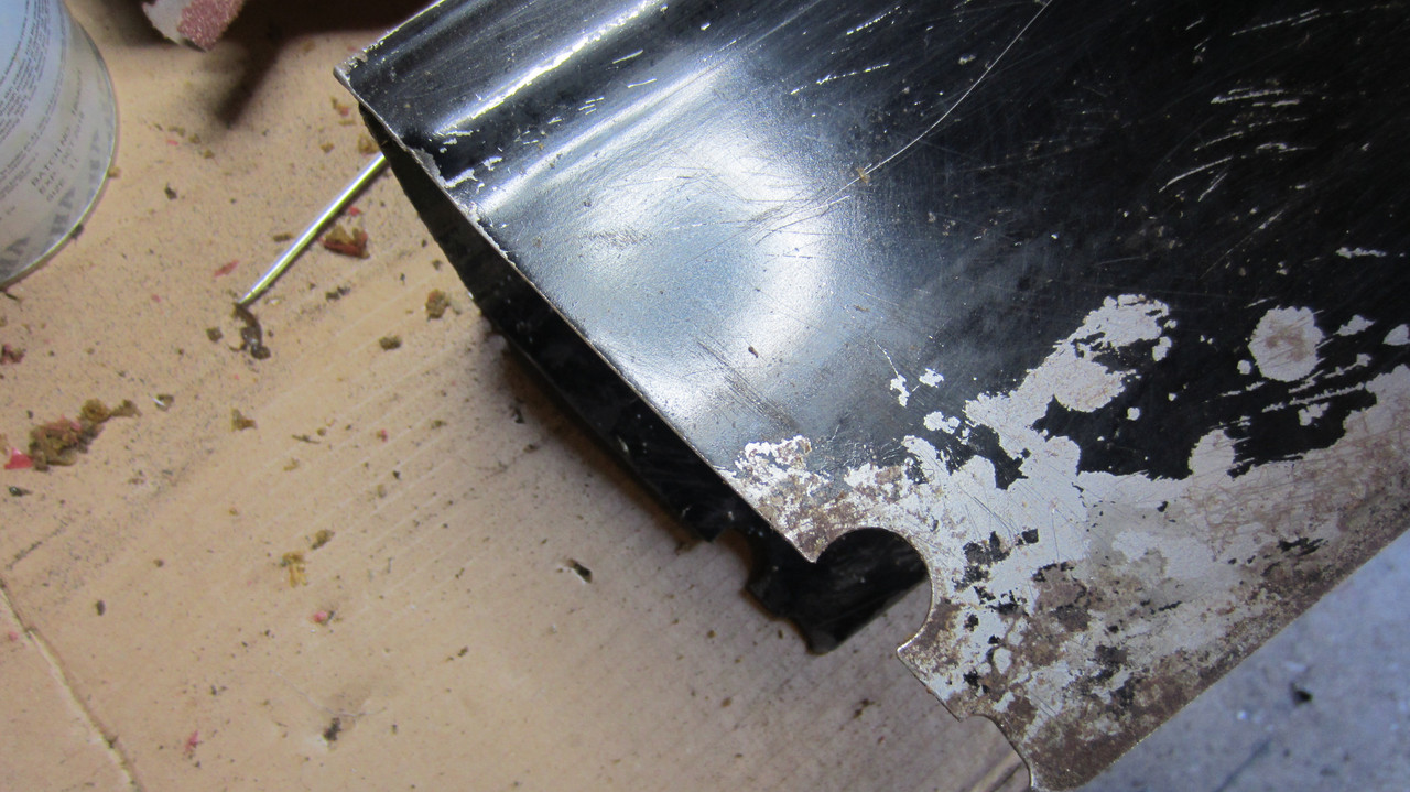

paulsco
Posts: 825
Location: Oxfordshire
#6 Re: Fixing the Y trim piece on centre console
Post by paulsco » Sun Jun 16, 2019 9:55 am
Hi Guys,
Thanks for your responses.
Here are some ugly pictures of what I have:
So the Y piece is held on with the tabs; thank you Andrew.
My Y piece, the brown crushed velvet in the picture, from what I have discovered so far, does not have the tabs at the front, so this needs to be addressed, but at the back, I can see that two tabs could hold it on in the hand brake hole, but I can't see what would hold it on on the right hand side.
Rory; I am not sure if the early 3.8 one would be the same length as the 4.2, but would be grateful for the measurement if it is not too difficult for you. I can work out the length of the Y piece from the cubby box position, but the main body is not so obvious.
Pete; thanks for the information on the fitting of the gauntlet panel and the 2+2 differences.
