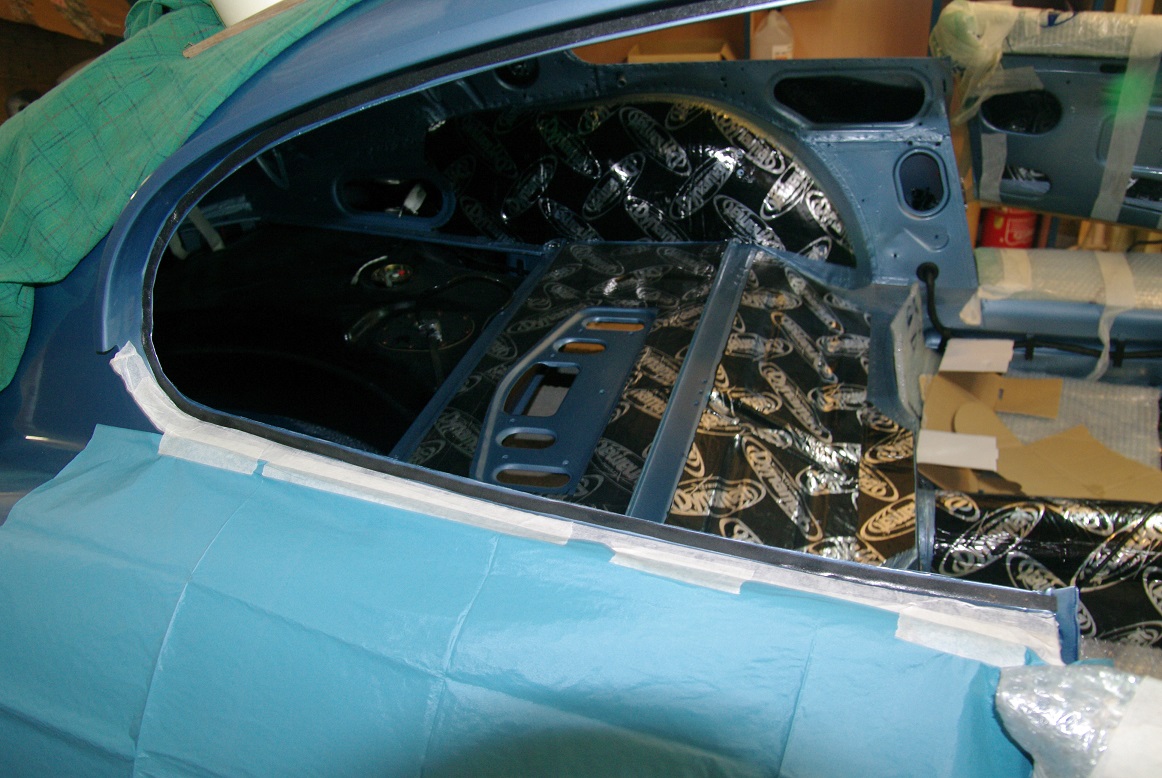

The shallow U shaped mild steel channel section which is fixed by rivets to the door and quarter light window opening....and which receives the rubber weather trim....to be precise
Should I be using the rivets with the rivet gun held inside the cabin or from the outside....I cannot recall how they were originally

They are riveted from the outside but a lot of people don't actually fit them, preferring just to glue the rubber directly to the bodywork.

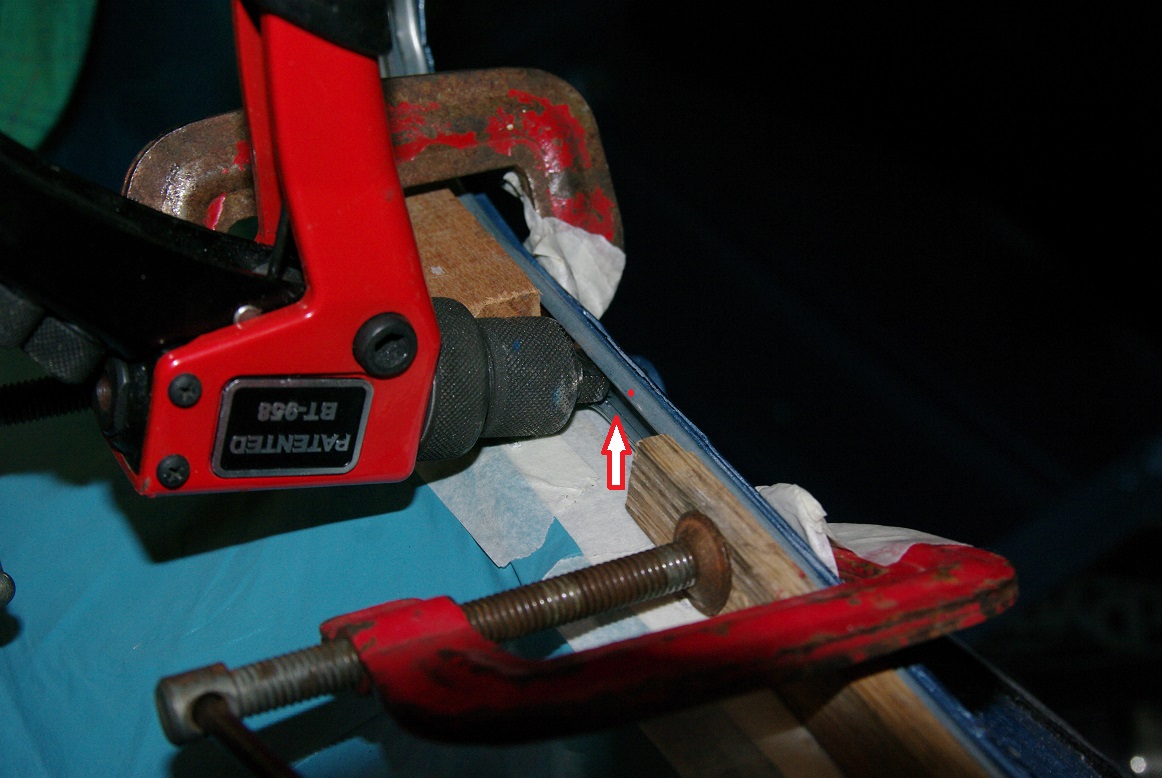

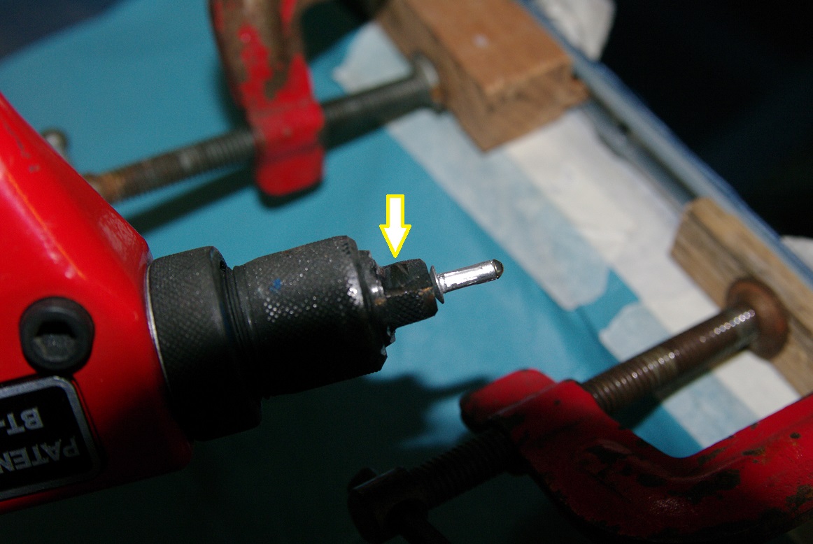

However...having now modified my rivet gun so the ends will fit into the channel i shall install as intended and try to use the shortest rivets in each case that i can get away with

Once I fitted my rivets (I had to modify my rivet gun too), I used a blunt cold chisel in the grove on the outside as a dolly and planished the end of the rivet flat(ish) on the inside.

This weekend I managed to drill all the holes for the channels...then cleaned/primed and top coated the channels....so either later in the week or next weekend I shall begin to fix them in place
Appreciate the photos guys...confirms what inhad suspected...
