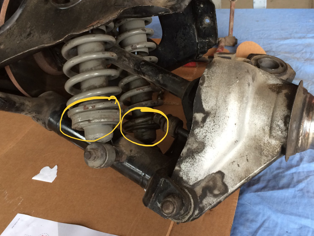

While talking about IRS, is there an explanation why my car had different size springs on the rear shockers (279mm plus 19mm spacer) compared to the front (284mm plus 4mm spacer) ?- see photo

Using different springs and spacers on the rear is unconventional but interesting. The stronger spring will always be progressively harder to compress, so mixing them does nothing for compression and two springs are always taking more compressive load than the other two. Conversely, when "airborne", the stronger spring resists stretching more and will max out in length but the weaker spring will then presumably allow the continuing pulling of the wheels down to the ground. What you have achieved is a differential performance in compression and extension. Whether that is a good idea or not - I have no idea. It is certainly needlessly confusing.
When not going over bumps, the default position is that the four rear springs take equal loading and that is why different strength and length springs are mated with different spacers. Think of as a straight line graph with two lines of different slopes. The crossover point (where spring+spacer lengths are the same) is the weight of the car when the suspension is not moving.

I'd be more worried by the use of dissimilar springs and spacers mixed up in the rear cage.

I would have some trepidation about having differently adjusted springs on the IRS however. If, for example, the rear spring is stronger or longer than the front one this might tend to make the IRS tilt front down under load, which might be bad. Now I suppose that it is possible that your rear springs have been tested for spring rate and length, then shimmed to ensure all 4 are identical, but if it were my car I would want to confirm that before reinstalling the shims.
So my advice, for what it's worth is use whatever shocks take your fancy at the front and use your Boges on the rear, but get the springs checked first so you know that all 4 have the same compression rate.

I have never been comfortable once I discovered that I had different springs, so I am happy to take the advice to either get them tested as they are or to replace them. We feel my car was raced a bit based on the panel damage and hasty repairs so the springs may have been a victim of “get it ready by the weekend”. Replacing them seems a sensible option as has been advised. I have a bit more reading to do of older threads to find my best option to source springs ??
