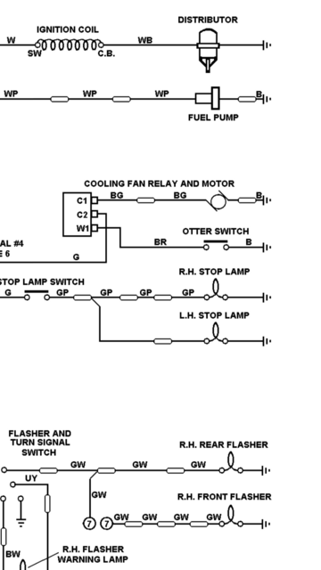

Posts: 1655
#5 Re: Two Black Cables 3.8 Roadster
Post by rswaffie » Sat Sep 07, 2019 2:51 pm
Sorry, I meant the cooling fan wires that go back to the relay. My 63 3.8 has the relay on the right as well, but the green/black goes across to the left where it goes to the fan. The wiring diagram shows it better...

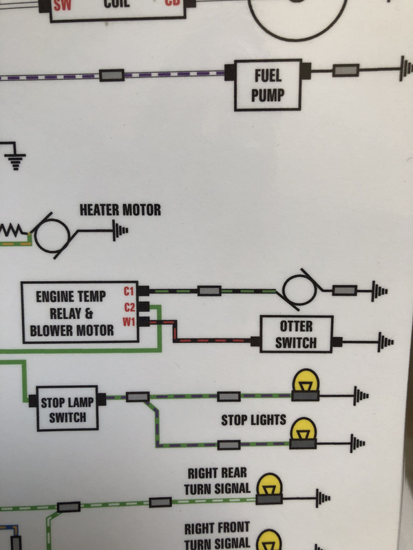

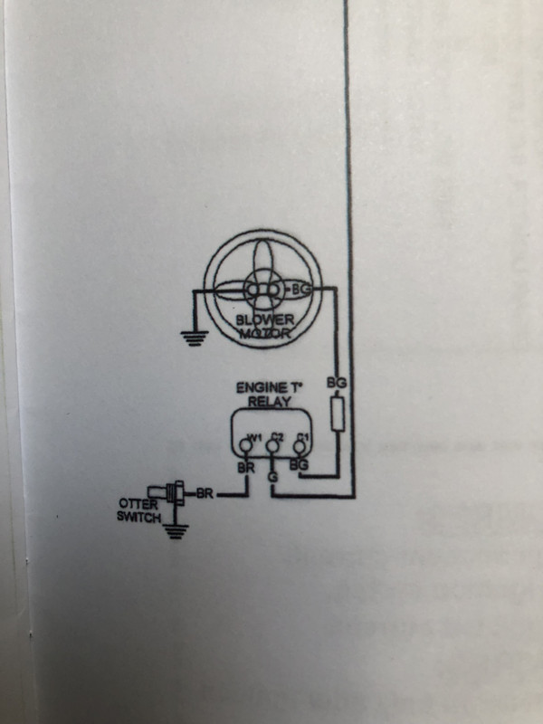

Post by Robbiee » Sat Sep 07, 2019 3:02 pm
I have just checked my Coventry auto components diagram and my Prospero’s garage poster
Both suggest it’s the earth and relay supply to the cooling fan motor bullets...as Richard states
Robbie

Post by Robbiee » Sat Sep 07, 2019 3:04 pm
Here!?
