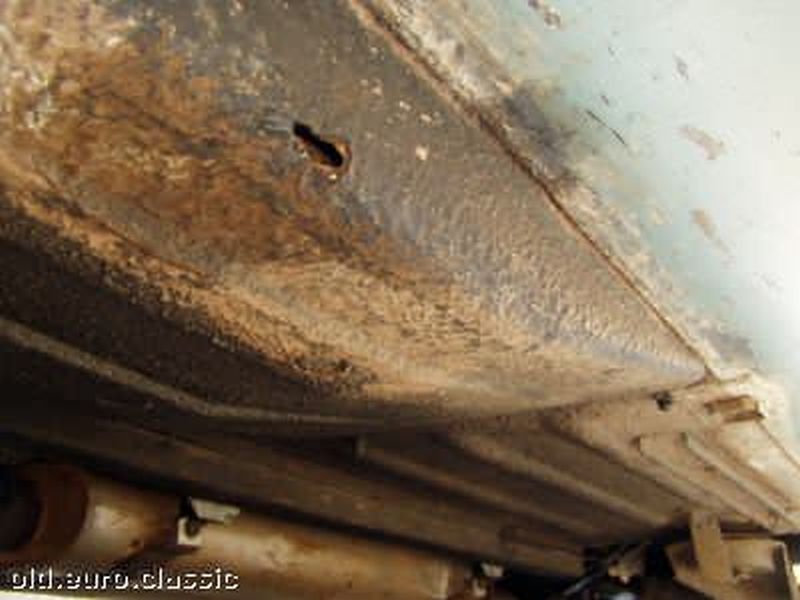

However the photos of the cars in the Factory Fit section (which I picked for this topic) show different on the underside of the car:
- front wheel arches are rubber coated, same for the engine shields,
- floor black (on white the car).
Do you think they are not that original after all?

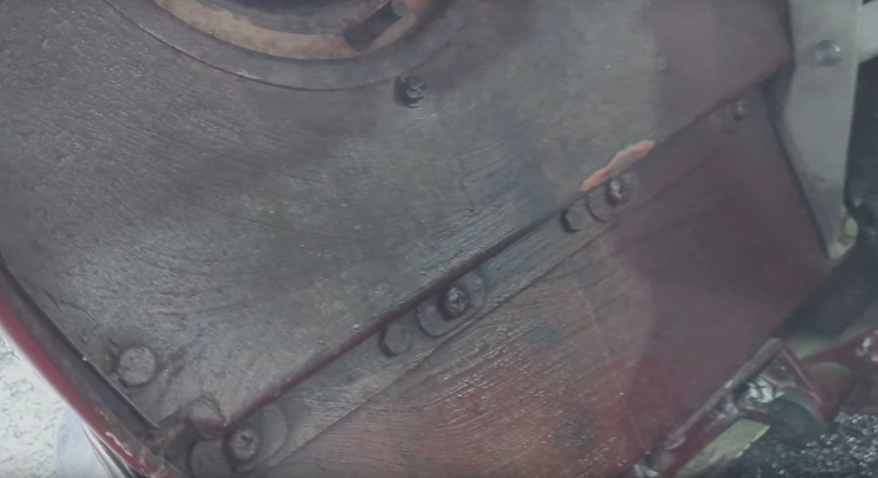

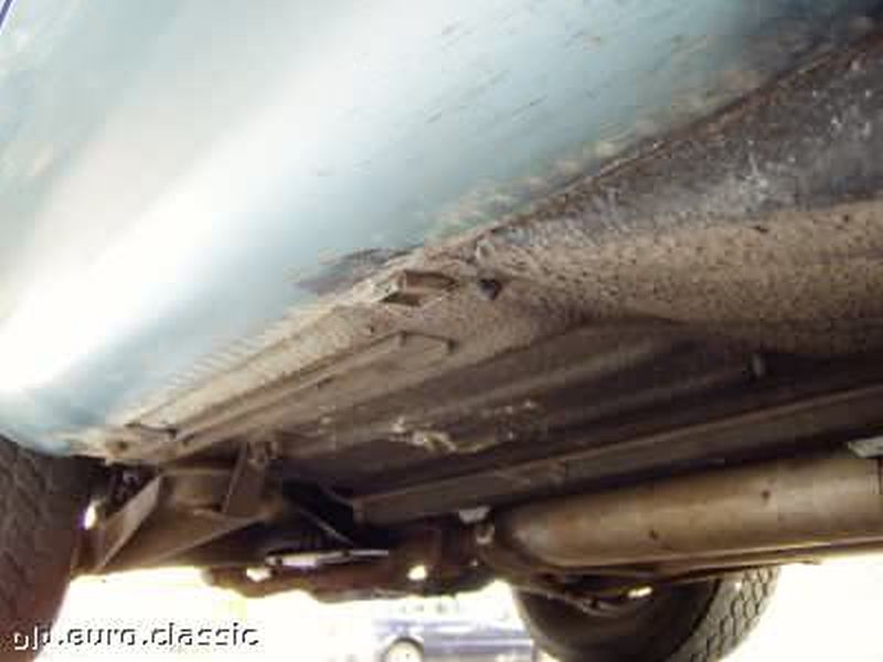

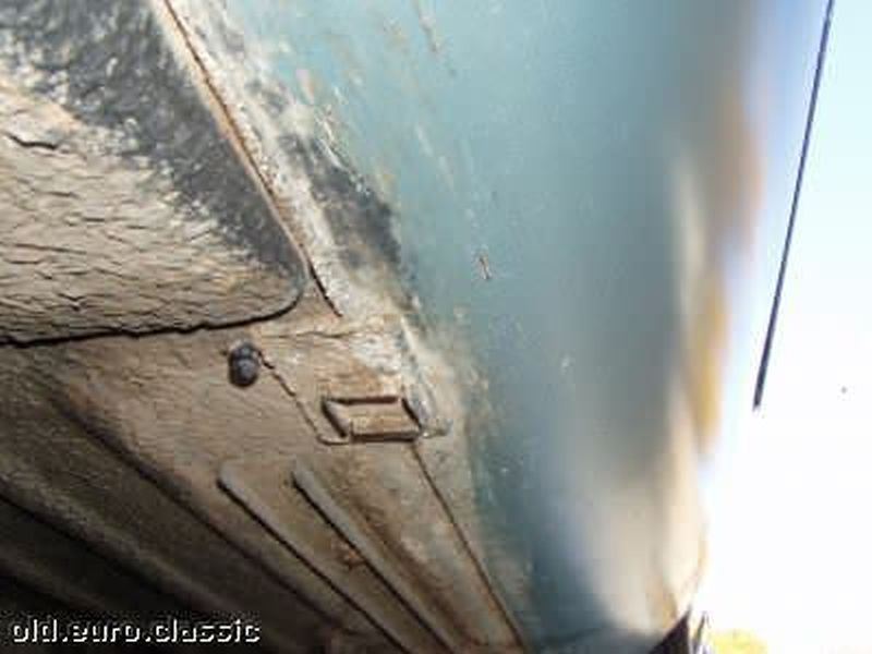

#4 Re: Wheel inner arch & floor paint in original S1 3.8
Post by ysmalkie » Wed Sep 25, 2019 6:18 am
Few more shots, this time though of the unrestored 4.2s:
Tadek
