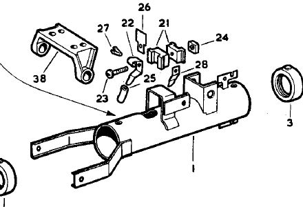

I'm in the process of rewiring a '67 4.2 Coupé. I have a purple/black wire for the horns near the steering column. I can't seem to find the horn slip ring that it should plug into. Any help would be appreciated.

You may lack some parts. SNG has a set of spareparts for this I found very useful.

Andrew is correct
22 is technically not the actual slip ring but it is the contact which is spring loaded and sits on it
