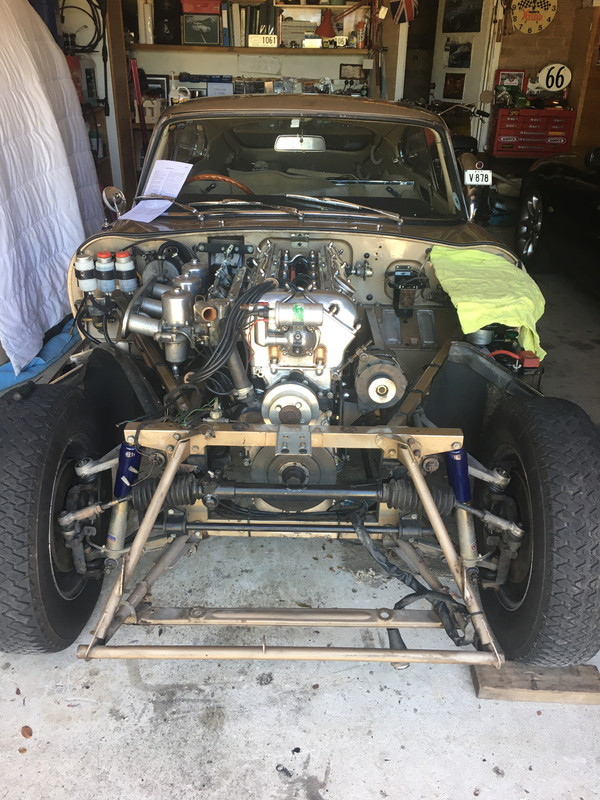

Hi Gent’s,
Well today I removed the bonnet and rad, fan, header tank, air cleaner, oil filter etc etc. Still a bit to go. Without the luxury of a hoist in my garage (or the height to use one) I’m going to pull the engine out the top. I’ve done it this way previously on my last S1 so I do know what I’m in for.
The question is, do I split the ball joints to get the torsion bar reaction plate off or try tapping the bolts back risking thread damage. On my last effort I ended up having to replace said bolts as they were damaged which necessitated splitting the ball joints in any case.
Any tips that the factory workshop manual
doesn’t cover would be appreciated, particularly from those who have done this more than a few times!

Hi Pete....I would go with splitting the balljoints so the tension is off....so long as you have the room and dont need to wheel the car about....Steve

Thanks Steve, yes I’ve got the room to do it.
It seems the preferred method is to remove the engine from the bottom. I’m wondering if I could, in fact, raise the front of the car high enough to get it out. I don’t know if my borrowed engine hoist would raise the car enough though. I’d also need to construct an engine trolley.

Hi Pete...just an example photo from Chris Vines Blog ... i think its less of a lift than taking engine out the top

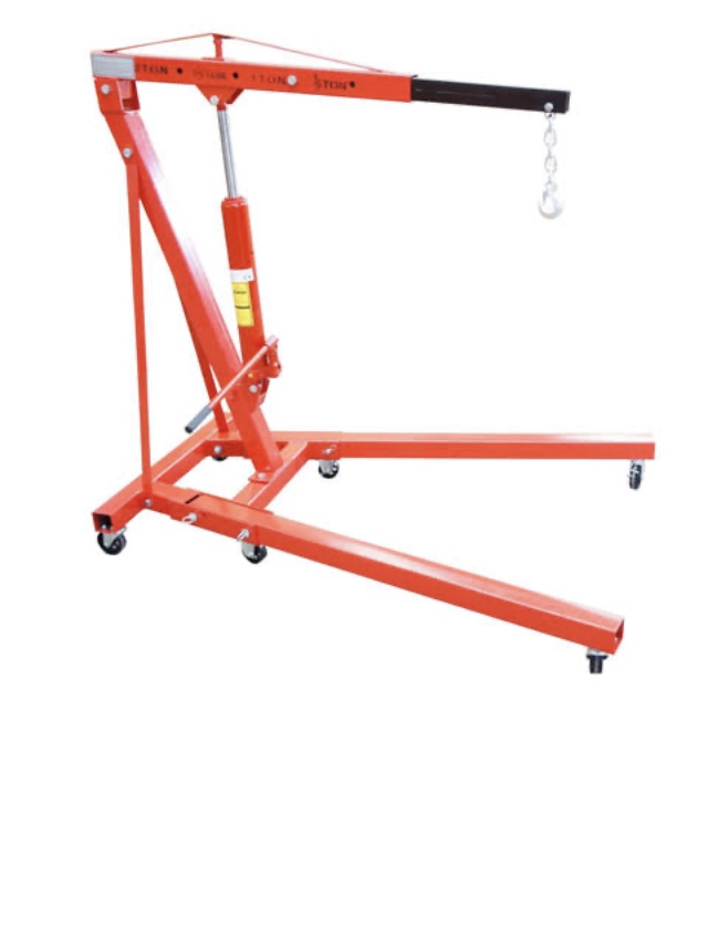

I think the engine lifting hoist I have will not allow the engine to be rolled out from under the car, as front or side on, the legs will be in the way. Ideally for this you need an overhead gantry of sorts.
Pete
peters3103
Topic author - Posts: 500
#8 Re: Engine removal
As pictured.

Hi Pete...you shouldnt have a problem with your lift....dont make your engine trolley very wide so the engine wheels forward inbetween the legs....if you do run into problems once the body is lifted you can always use blocks to hold it up in position and remove the lift....As Andrew says above raising the rear will help......Steve
