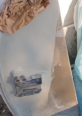

I have one part of the car that has original paint on my '63 e-type:
I kept it covered throughout the restoration process and it has been always covered by upholstery:
We tried to match the paint to this B pillar, and it seemed that Glasurit was very close. We made 6 different variations of Glasurit paint by playing with the colours:
As you can see the variations were subtle - the 6th one (not on the photo) was the best one, made with a different technique.
