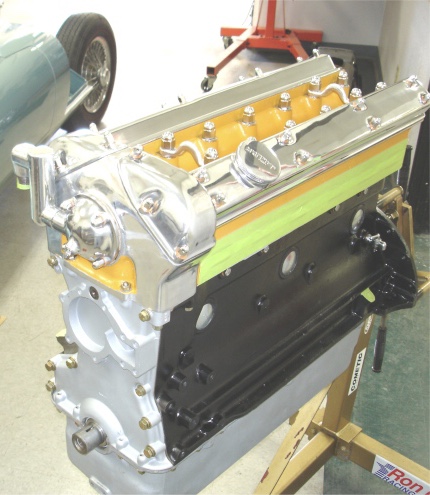

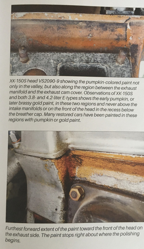

Hi gents,
Despite a good search I’m yet to find consistency (or photos of the same head on all sides) to confirm exactly where paint should be on my 3.8 head. Is the recess below the engine breather painted? Exactly where on the sides and back are painted? Any correct photos or info would be much appreciated.

#2 Re: Cylinder head: where to paint?
Dunno whether this is right but this is how I do them.

#3 Re: Cylinder head: where to paint?
Thanks Andrew, I’ve seen them painted below the breather and also above the exhaust manifolds - ie all the rough cast areas. Mine was done like that but also unsure if correct.

#4 Re: Cylinder head: where to paint?
Pete

#5 Re: Cylinder head: where to paint?
Pete

#7 Re: Cylinder head: where to paint?
Dulcie must’ve painted the one in my first pic - merkin and all!
I’ll leave the merkin off mine - it looks better bald.
