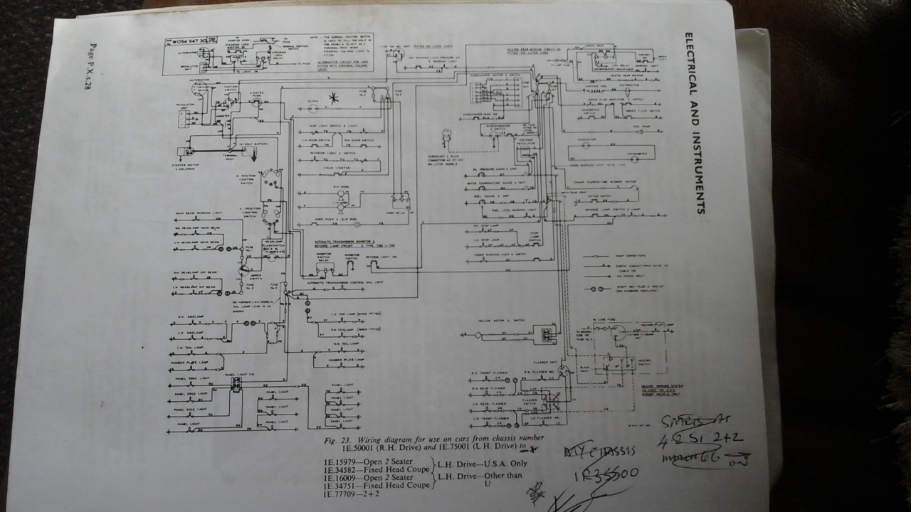

Hi Paul just to try to help i went through the wireing diagrams in the big green Jag service manual....others im sure will jump in with additional info.....First wireing diagram for 3.8 cars shows an ignition warning lamp comming straight fron the controle box....so just ignition........The first diagram in the 4.2 section(it does give chassis numbers).. has a 3aw which operates an (ignition warning lamp) so this is controled by the alternator....connected in parallel to this lamp is an oil pressure switch. .....the lamp is lit till oil pressure builds up or until the 3aw operates.......The later S1/ S2 diagrams just have the lamp operated by the 3aw.....
So as per your findings the duel purpose lamp will remain lit untill both the pressure switch and 3aw operate...however under normal operation with the car running the lamp will be lite by a loss of oil pressure or a loss of charge......hope this helps....Steve

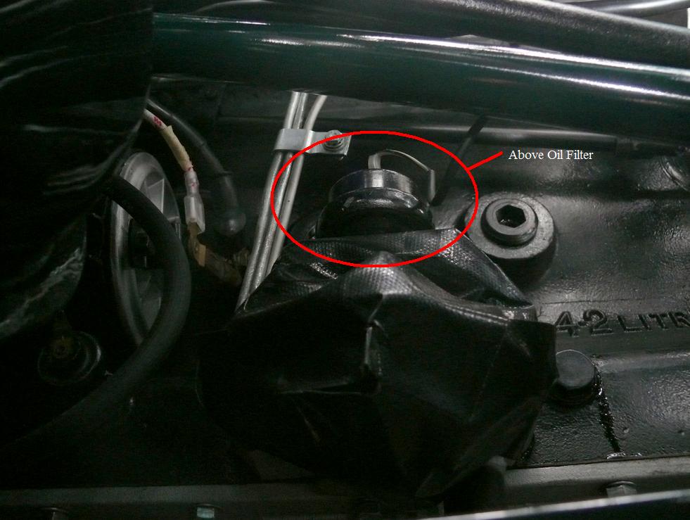

I have a 1966, S1 2+2 in work for restoration. It has three Oil Pressure Senders; one for the Oil Pressure Gauge, one presumably for the Oil Pressure Warning Light and one presumably for the Ignition Light. It only has a light for the Ignition and no separate Oil Pressure Warning Light. There is definitely no evidence via the original wiring that it ever had a 3AW.
I can see the logic (at a stretch) in the 3AW and Oil Pressure Sender driving the one warning light. But to have two separate Oil Pressure Senders to drive the same Warning Light for Oil Pressure and Ignition, which must be the case with this car, just doesn't make sense. If the Oil Pressure is non existent before the engine is started, then the Ignition Light is on. If the Oil Pressure were to drop when the engine is running, then the Ignition/Oil Pressure Warning Light comes on; both scenarios could be accomplished with the one Oil Pressure Sender.

in the black Bentley book and an old Haynes manual there is a wiring diag for 3.8 cars with no 3aw, next diag is on 4.2 models from referenced chassis numbers that shows both the “ign warning light pressure sw & warning light” and a “3aw ign w/l unit” circuit both going to the same circuit. Next to the 3aw circuit it says “(Fitted on later cars)” so it would appear there was a transition on the referenced cars from the pressure sw to the 3aw rather than both at same time. The next diag for following referenced chassis shows only the 3aw.

Hi Paul.....yes you last sentance is how it would work if wired as shown in the diagram....however we dont know how you have wired yours.....do you have a wireing diagram....Steve

Interesting, so on those cars factory was both the 3aw and the oil pressure sw wired together with the two circuits effected the light independently? So you could have oil pressure drop with good charging and the light would come on?

See diagram top center

Yep, that's the same one I'm looking at but I was thinking that when it said "later cars" it meant the oil pressure sw circuit was eliminated and was replaced by the 3aw circuit in later cars. I don't have a car of that vintage to look at and I was just postulating on that assumption so I could be wrong. Interesting.

Hi Layne.....note the chassis numbers...the next page in the service manual has the next diagram for later cars with just the 3aw and ignition lamp ...no oil pressure switch...Steve

I have both the Jaguar service manual and the Haynes Manual, which both show the two different wiring diagrams for the Series One 4.2, but both have the 3AW in the circuit.(I know some don't)
The first one however does not show the oil light in the circuit, but the second one does.
I may be misunderstanding them, but my chassis number does not appear to be represented in ether.
The Series Two just has the ignition light and the 3.8 has another different wiring diagram and with the dynamo only a ignition light, not both.

Hi Paul..at the bottom of the diagram i posted above the note says the diagram is for cars upto 1E354582.so should include yours?.....Steve

All looks quite original; three Oil Pressure Senders on the RH side of the Block. The owner is rewiring the car and I give assistance when he gets stuck. The old loom had been removed and the new one roughly in place when he asked the question regarding the three Oil Pressure Senders.
The old loom has three wires coming out of a very original looking, cotton braided covered loom, which correspond to the position of the three Oil Pressure Senders. Immediately I suggested that one would be for the Gauge, one for an Oil Pressure Warning Light, and one for the Ignition Light; that would have made sense. However, on inspection, there was no separate Oil Pressure Warning Light.

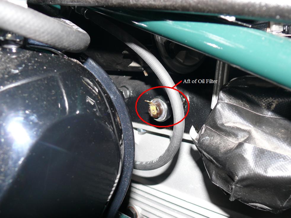

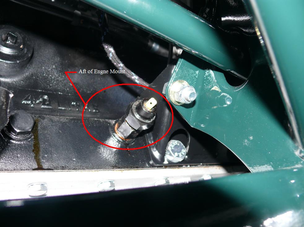

Following are pictures of the three Oil Pressure Senders on the RH Side of Block. I'll have to wait for the owner to bring the old loom back in to take pictures of that, but there are three wires, each corresponding in position to the three Oil Pressure Senders respectively. Each of these wires emerge from a very original looking, braided cotton covered wiring loom.
Above Oil Filter
Aft of Oil Filter
Aft of Engine Mount

The one above the filter is the sender for the electric oil pressure gauge, (white/brown wire).
One of the others, I would guess the one nearest the filter would be the one for the ignition/oil light Brown/black) (pressure only works the oil light, or more specifically lack of pressure).
The other one is not original as far as I know; could it be for a separate oil light, i.e. one that works independently of the ignition light??
Be interesting to know what colour wires are attached.
Just thought; one is not for oil temperature is it?
