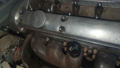

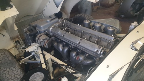

I've now applied the Calyx to the manifolds.... It was very easy to apply (with a toothbrush) and had the added benefit of not having to take the manifolds off. Once applied, the engine had to be run for 20 minutes or so for things to cure (a bit of smoke came off so best to do with bonnet open).
Prior to application, my manifolds had been painted with black bbq paint which looked good to start with but faded to a brownish hue after a couple of years. It was therefore a choice of either doing this again or trying something new.
Calyx is a graphite-based paste and therefore will not take your manifolds back to black. The end result is what I would describe as gun-metal grey with a nice satin shine. At the end of the day this all boils down to personal taste but, in the absence of buying new manifolds and potentially watching the gloss black coating cracking at the first hint of moisture through the bonnet slats, this seems a good compromise..... Certainly better than brown.
Pictures below..... comments welcome as always
Before Application.
Part-way through first manifold - difference already apparent.
First manifold complete - good comparison to the second.
Finished job after running engine.
