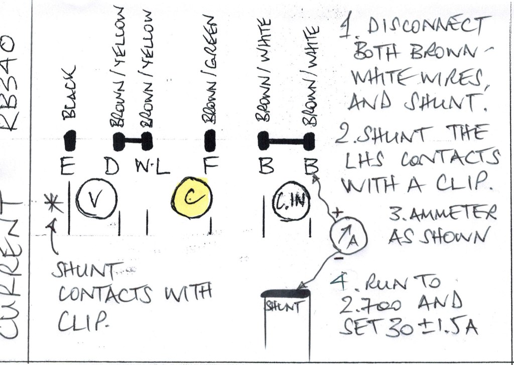

Preparation consists of

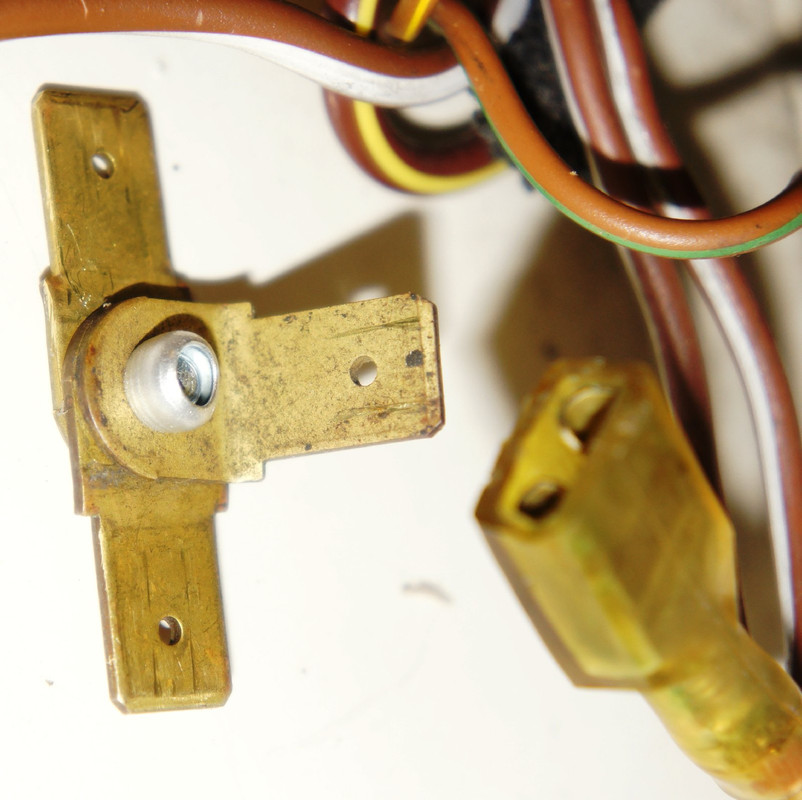

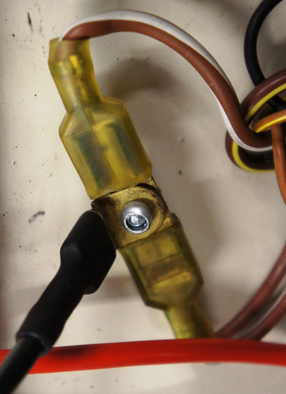

1. getting a decent shunt ready (see photo) for bridging the two 9.5mm spade connectors of the brown-white wires from the RHS terminals B-B (which are in fact common) once they?ve been disconnected from the regulator, I used three flat 9.5mm spades riveted together so I could also have a solid connection to an ammeter-wire for the Current Test.
2. removing the brown/green off the W-L (Warning Light) spade, and replacing it with an insulated spade plus short wire to facilitate its connection to a voltmeter.
3. finding a way of holding an accurate moving-coil voltmeter on a clamp or w.h.y. so that it can be used hands-free.

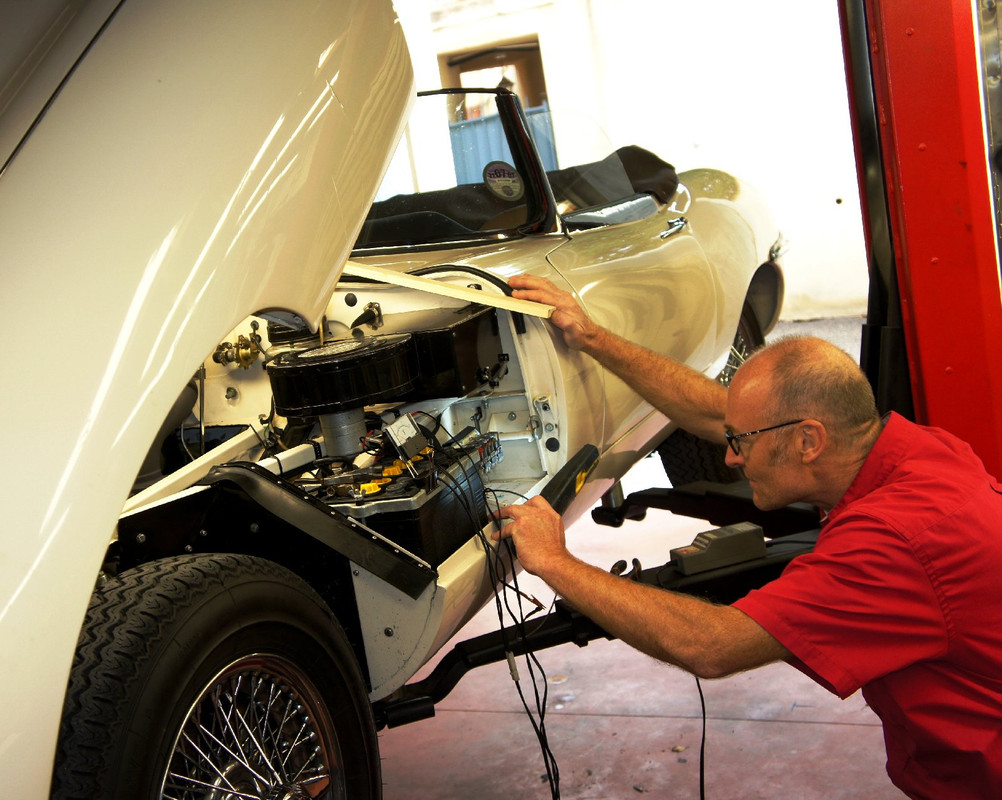

4. setting up some Heath-Robinson jury-rig so that the throttle can be operated from the regulator area - even if you have a second pair of hands and feet to help, I still think this was 15 minutes well spent, notwithstanding its disgraceful construction out of some scrap timber and a few dry-walling screws ; don't tell anyone I made this please.
I suspect that you can do these adjustments in whichever order you choose but like a good soldier I did them in the Lucas sequence.

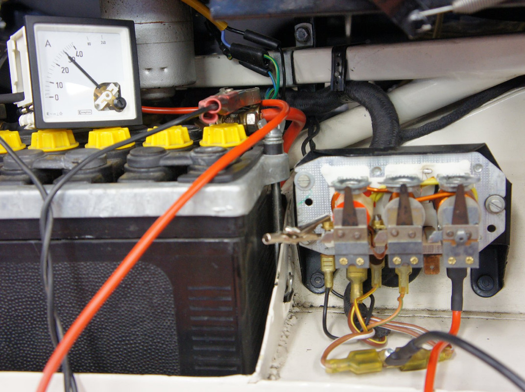

1. CURRENT - see Lucas Handbook pages 18, 19
This requires either an inductive clamp that will do DC or a serious industrial meter like this one I got for £15 on E-Bay :
http://www.ebay.co.uk/itm/AMMETER-0-40- ... 3f2c38b29b

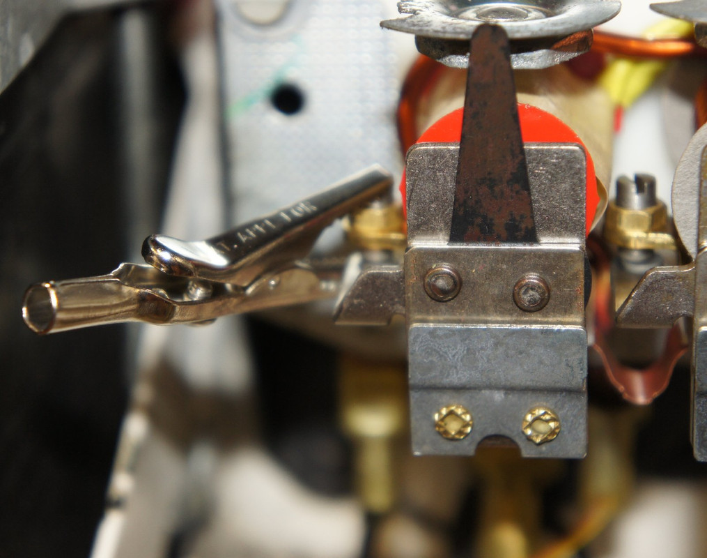

Use a crocodile clip to hold the points shut and bridged on the LHS/front of the RB340, and with the brown/whites disconnected from their B-B terminals and shunted together, connect them (via the shunt) to the -ve terminal of a 0-40 amp ammeter, and the +ve terminal of the ammeter to the B-B terminals on the regulator. Start the engine, switch the headlamps, panel lights, heater fan etc and run the dynamo up to 4.500 rpm (whatever engine rpm necessary for this, 2.700 for me) and check the maximum current - for the C42 used on my car this should be adjusted to 30A +/- 1.5A.

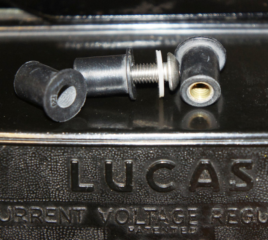

The cover on my car was held on by a two ghastly sort-of black nylon reusable pop-rivets, which I couldn't live with even if they were original - 5mm rubber Well-nuts require the back-plate holes drilling out to 9.5mm, and then you can use conventional screws ; I promise to replace the dome-headed Allens with something more "period".
