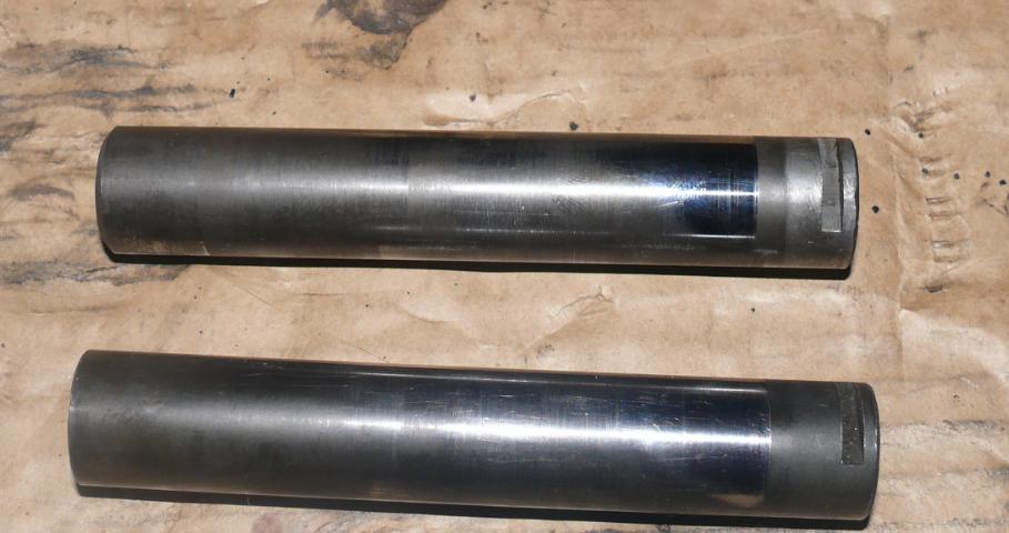

Following are pictures of the typical wear that is found on the Reverse Idler Gear Shaft when refurbishing a Jaguar 4 speed gearbox. If yours are worn at all, replacing the bushes in the gear is only a half baked job; the shaft should also be replaced.

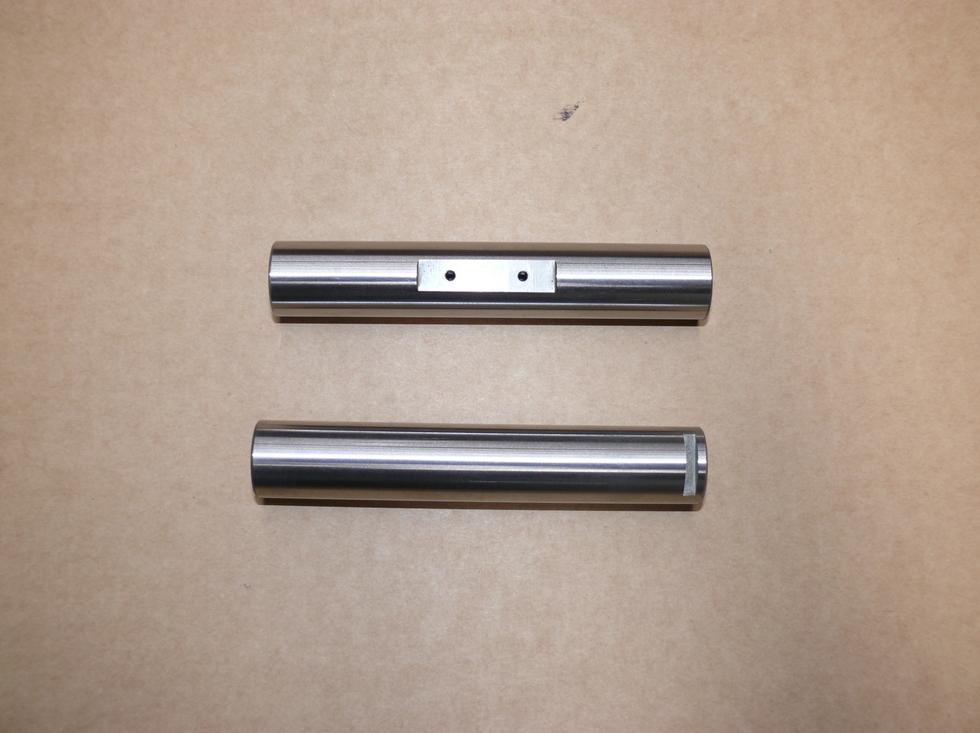

The following picture is of Reverse Idler Gear Shafts I manufacture; a better product than the original, being made of a more suitable material than used in the original and a better fit in the bore of the Gearbox Housing.
