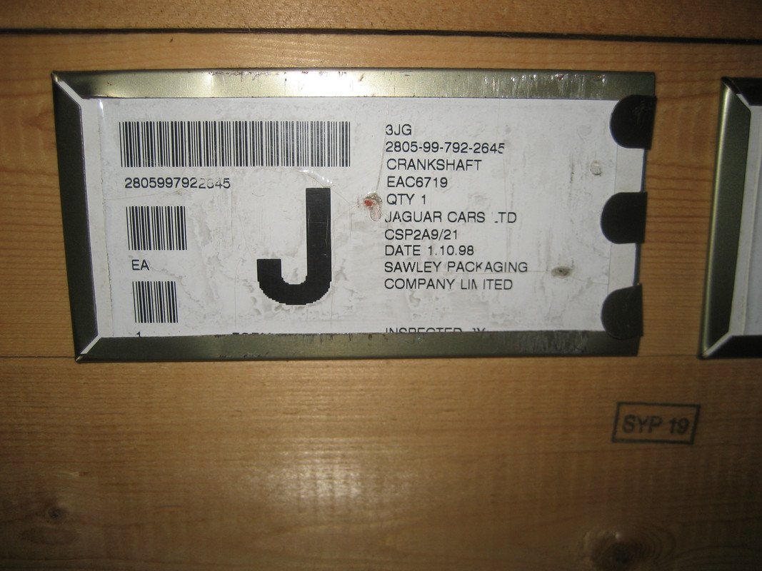

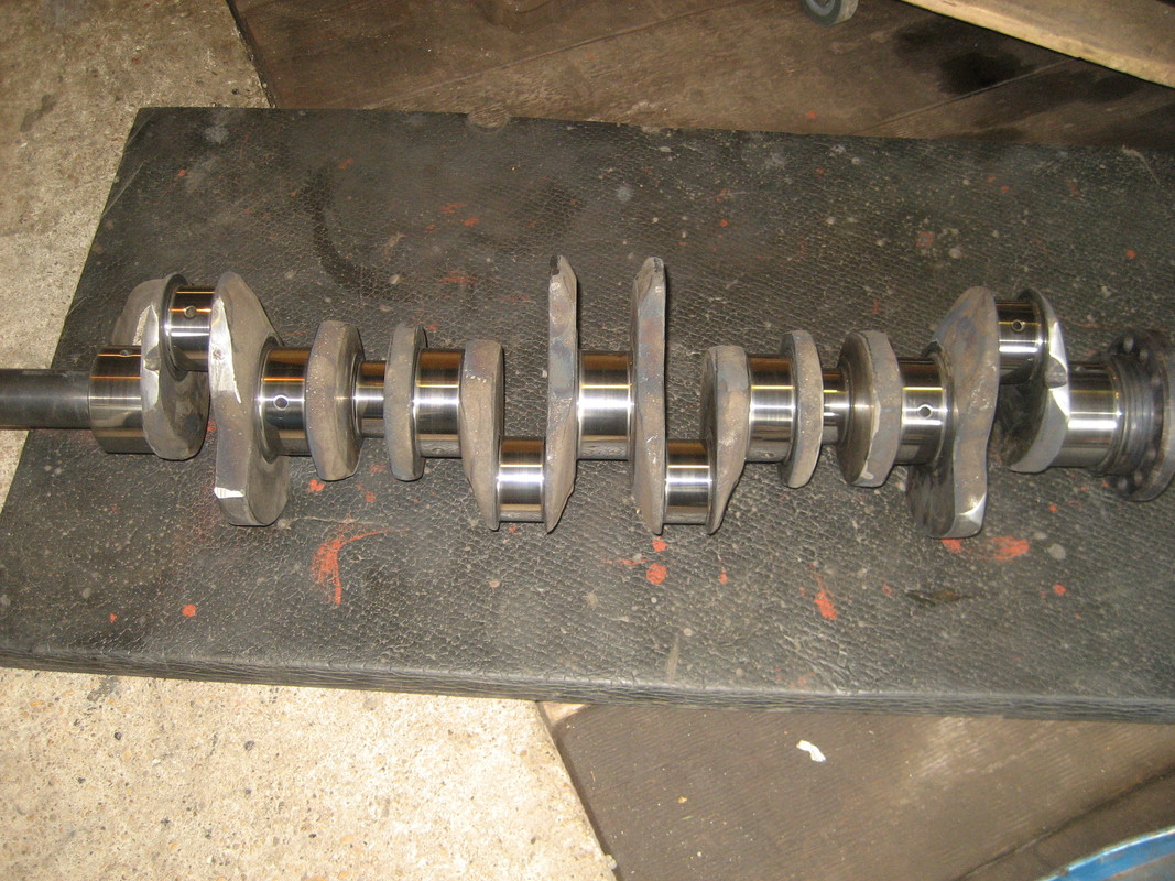

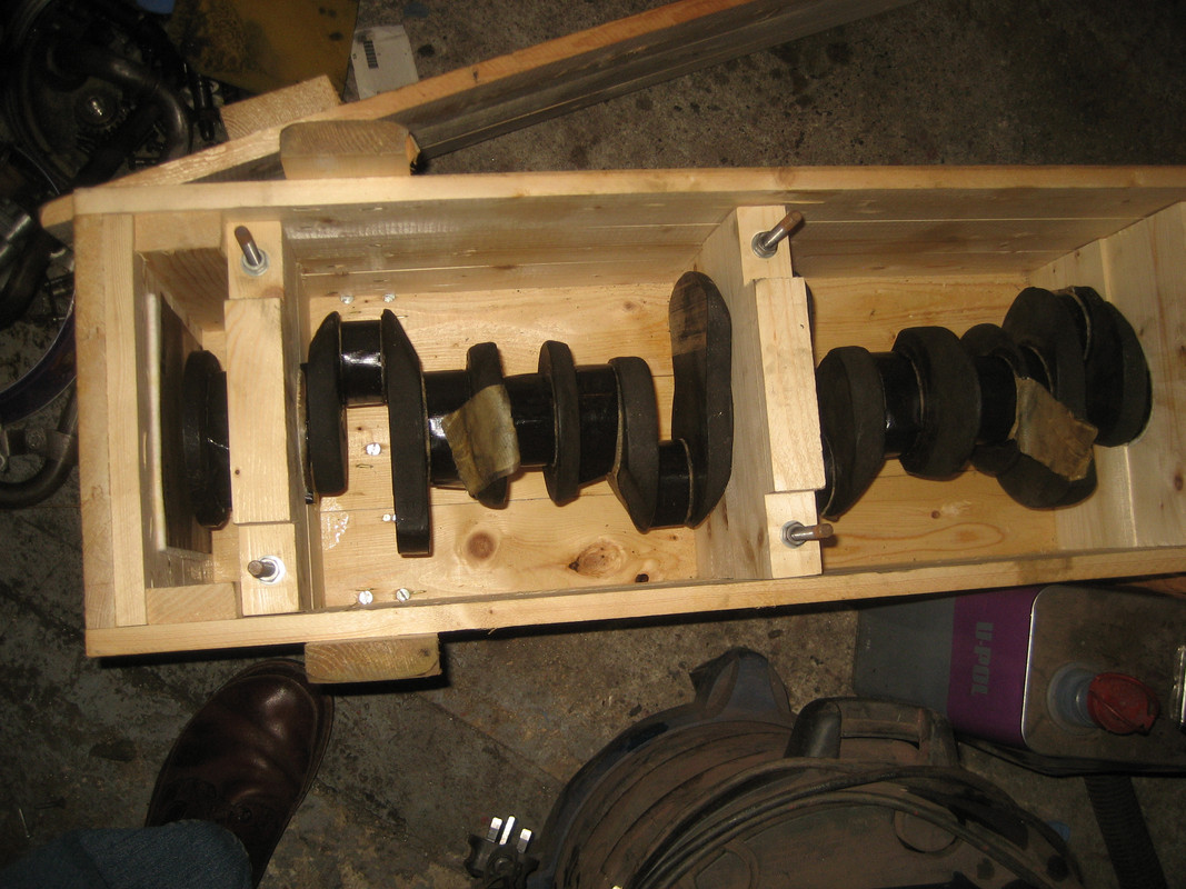

I bought a new crank from SNG a few years ago that was army old stock.
I think it was tuftried; were all the E-type cranks tuftried?
