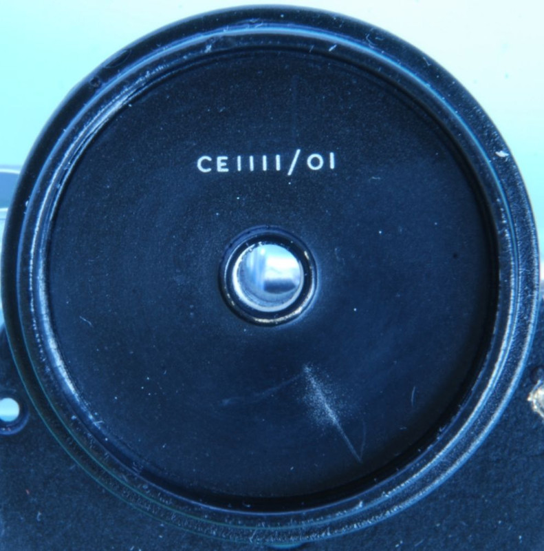

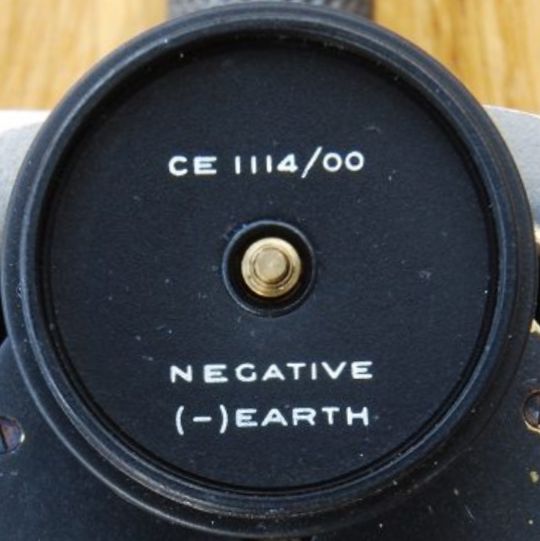

I think the numbers you have left on the face of the clock are the remains of the original Smiths Reference Number.
For a 1966 negative earth car it would have looked like this originally.
Whereas earlier positive earth cars had this Reference Number
Bob
