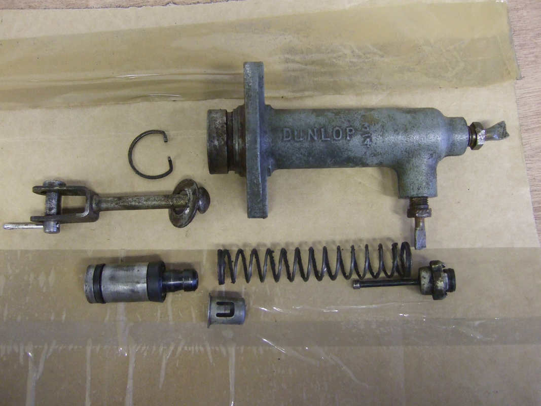

#7 Re: Series 1 - Dunlop Clutch master cylinder push rod length
Hi Tony,
If it’s any help, here is a picture of my clutch master cylinder from my ‘62. I didn’t measure the pushrod, but hopefully you can get a good estimate from the picture:
Simon.
Simon.

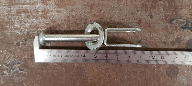

#8 Re: Series 1 - Dunlop Clutch master cylinder push rod length
This is the answer you waited for :
It's an original one with large washer.
The spacer came for the série 2 because of they changed the master cylinder (45°).
For the serie 1- 3.8 and 4.2 the master cylinder ( 90°) and pushrod have both the same reference into the well known provider as well as the pushrod for the serie 2.
Mich
