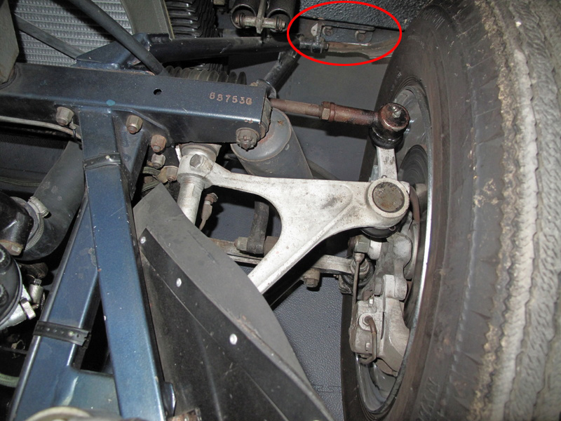

I fited the shims as view on the photo but with the hole in horizontal reverse . With the hole at the exterior of the hinge it's more easy to take it in or off.
Mich
Michel
288gto
Posts: 1417
Russia
#10 Re: '64 3.8 Bonnet fitment
Post by 288gto » Sun Oct 11, 2020 4:52 pm
Mich7920 wrote: ↑
Sun Oct 11, 2020 2:23 pm
Mich
Interesting Michel. I have always fitted them hole inwards because I thought it offered more support on the load bearing part of the hinge? With the hole at the pivot end there is also less of the shim on show. I wonder how they did it at the factory?

Mich7920
Posts: 777
Location: France
#11 Re: '64 3.8 Bonnet fitment
Post by Mich7920 » Sun Oct 11, 2020 7:09 pm
I think that when the screws are teighten, there is no effort in diagonal but in longitudinal so the shims are enought in contact. But I also might be wrong... No, I don't thing so :bigrin:

The factory fitted the shims as in picture 2

Mich7920
Posts: 777
Location: France
#15 Re: '64 3.8 Bonnet fitment
Post by Mich7920 » Tue Oct 13, 2020 6:50 am
Simon, you were right and I was wrong! :oops:
Photo from factory fit
Michel

#16 Re: '64 3.8 Bonnet fitment
