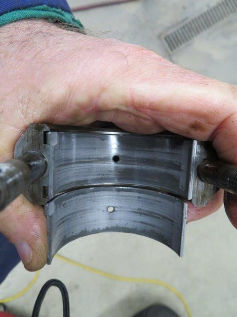

On the main bearing bolts, there is a washer to replace the lock tabs now? The engine stand idea works wonderfully!
Time to replace the con rod bearings...

#9 Re: Engine Stampings
Post by mxke » Mon Oct 26, 2020 11:34 pm
Posts: 4081
#10 Re: Engine Stampings
Post by abowie » Tue Oct 27, 2020 2:28 am
mxke wrote:
Mon Oct 26, 2020 11:21 pm
All but one cotter pin was still in the castellated nut.
Replace all of them with new bolts and nuts.
I see you plan to replace the conrod bearings. Have you replaced the main bearings as well?
mxke
Posts: 156
Location: Penticton, BC
#11 Re: Engine Stampings
Post by mxke » Tue Oct 27, 2020 4:06 am
They will be replaced as well.
