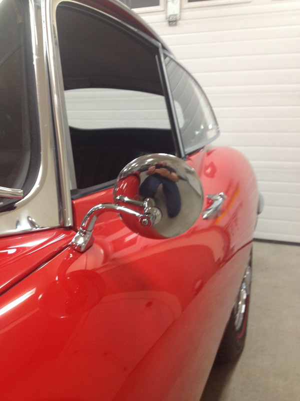

3" hotrod mirror clamps to the door edge-no holes! Works well for me. Speedwaymotors.com has them, but should be available from others as well.

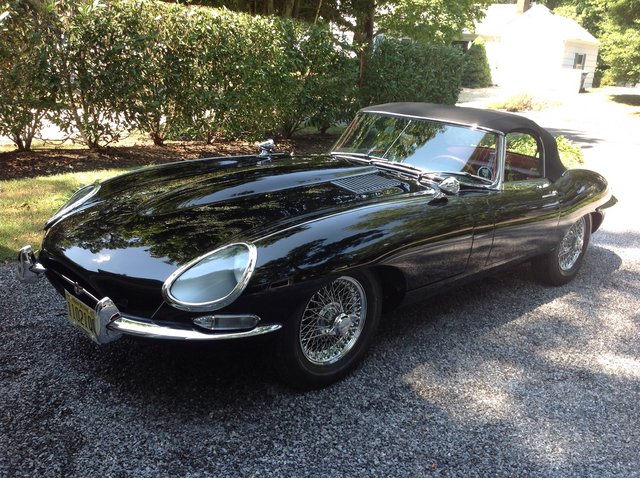

I’m happy with this pair of vintage Talbot bullet mirrors mounted on my bonnet:
Alan

Hi, I did it like Steve. I´m happy with the view and there is no need to drill a whole into your bonnet.

So i see Speedway has both a 3” and 4” mirror that look the same.
Steve is using the 3” and looks like Martin you are using a 3” also.
So how is the wind noise from the mirror you guys?

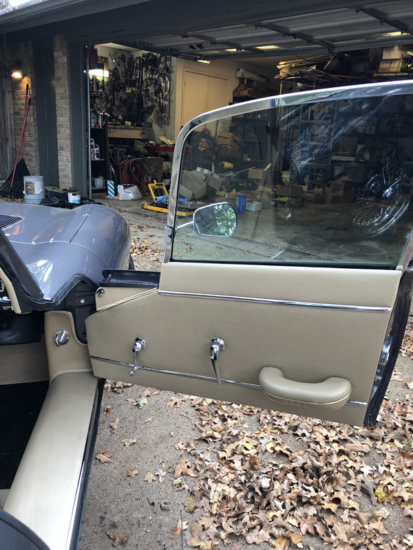

This is a TEX offering from XKS/MOSS, and I believe SNG among others. I modified the mount bracket to fit over the forward edge of the window frame. It stays put with rubber inserts between the window frame
and the brackets, but even if it came loose it would simply slide downward instead of bouncing down the side of the car. Enlarging the photo gives a better view of the modified bracket.

Looks good. What did you do to modify the mount?

Cut the bottom out of the original bracket "U" and welded in a wider piece that was sized for the window channel (plus rubber spacers).
I might raise them higher on the frame to reduce eye/head movement when driving.
