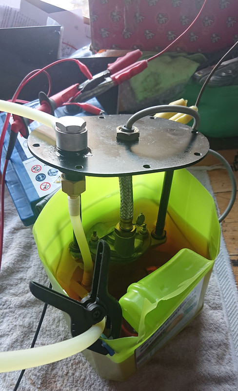

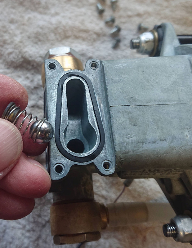

ysmalkie
Posts: 550
Location: Poland
Poland
#7 Re: Lucas 2FP pump
Post by ysmalkie » Wed Dec 16, 2020 2:35 pm
I thought I would revive an old thread.
I managed to purchase a NOS 2FP few years back for my e-type.
Once I finalny cleared all obstacles to install the fuel tank, I wanted ot fit the pum and test it - unfortunately it did not work.
I took it out on a bench, and all it could do was to pump the fuel about 10cm up the pipe..
So, I too apart the impeller housing, all was good and moving.
Then I opened up the valve, and to my surprise.. there was no valve!
Seems someone in '66 forgot to fit the ball and the spring.
Thankfully I had if from my old pump:
And it tested fine:
