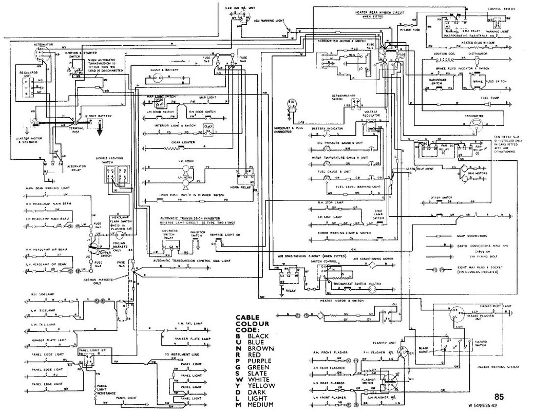

What do you mean only had 2 wires originally......when you got it or from the factory when built.......was this car a runner when you got it?..........dont think iv seen a diagram with only 2 wires on the ignition switch..........the service manual has wireing diagrams to cover chassis numbers.....have you looked that up.....i would suggest there should be at least 3 wires.....one main live......then one for ignition etc then one to start.......there is a 68 wireing diagram showing a brown a white & a white/red........Steve

I would have thought that there must be at least one plain white wire (switched unfused power) going from the ignition switch to the fusebox. And another white wire to the coil.
Otherwise there's no power going to anything.
You may have the wrong loom.

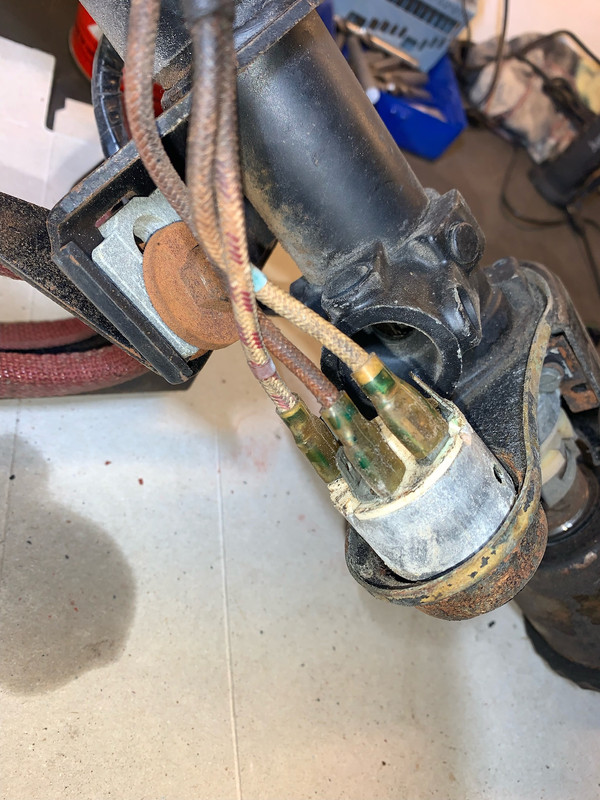

Simonpfhc
Posts: 777
#12 Re: Ignition key starter for series 1.5
Post by Simonpfhc » Sun Jan 30, 2022 1:20 pm
Ok, I’ve had a look at the original column/switch assembly that came off the car that I've currently got in the workshop. From the witness marks, it looks like it is missing one of the two brown wires, but it still has the white and white/red wires attached.
So, as already mentioned correctly in previous posts, there should be a brown wire coming directly from the battery post to the switch, and the second brown (piggy-backed at the switch) from the switch to the starter solenoid. The white goes to the fuse board to power all white switched circuits and the white/red to the starter solenoid to activate it and send power to the starter.

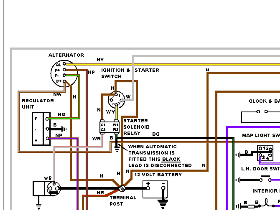

Have a look here..its should explain the connections...Steve https://forums.jag-lovers.com/t/66-fhc- ... ect/353619
Heronscourt
Posts: 86
Joined: Thu Jul 09, 2020 4:19 pm
#17 Re: Ignition key starter for series 1.5
Post by Heronscourt » Wed Feb 02, 2022 11:40 am
Thanks Steve, David's clearly annotated photo is very helpful. My only follow up query is that the description is for a car with a starter relay and the White/Red wire to tag F is from the relay. My car doesn't have a relay, the White/Red wire is direct from the ignition switch. Am I correct in assuming that this wire provides the same function and is stil connected to tag F?
Thanks once again for your help
Alan
Alan R
Etype series 1.5 roadster 1968
Posts: 9215
#18 Re: Ignition key starter for series 1.5
Post by mgcjag » Wed Feb 02, 2022 11:59 am
Hi Alan...refer to the diagram posted above for the ignition system without a starter relay. ....i dont want to tell you yes or no as getting the wireing wrong on the starter circuit can cause burnt out wires....so i refer you to diagrams. ..if you dont understand them then maybee a time to call in an auto electrician......personaly i would upgrade to a starter relay......Steve
