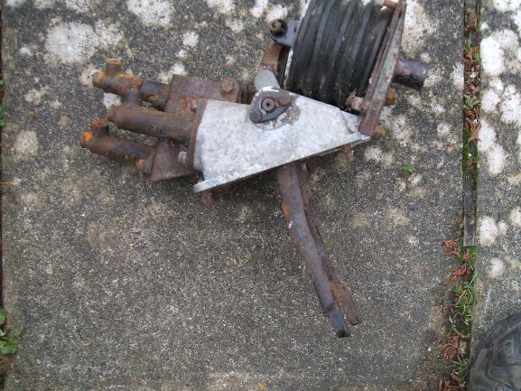

Level with the clutch pedal works best Robee. I don't think there is any art to it. I have a couple of 3.8 pedal boxes off the cars if you want a photo.

A picture might help please

RHD pedal box from a '62
