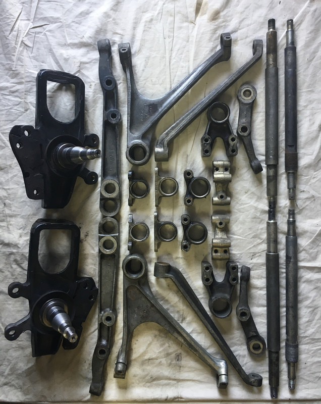

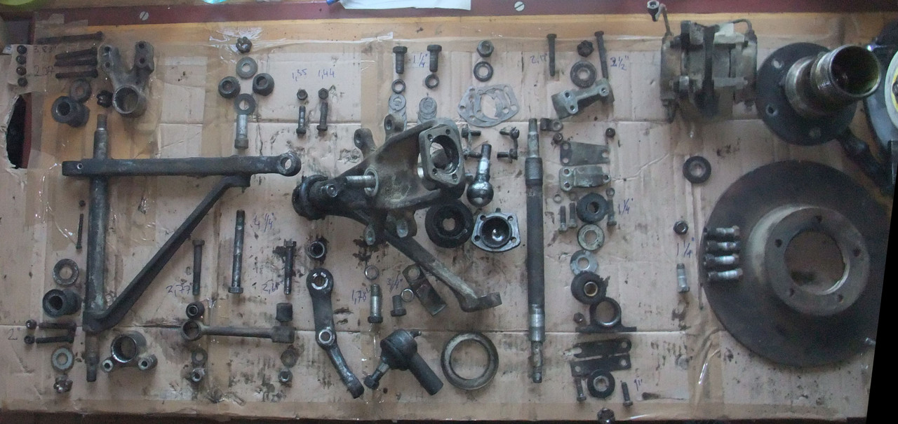

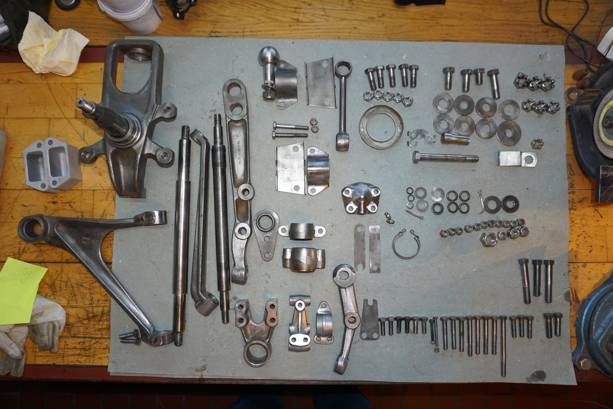

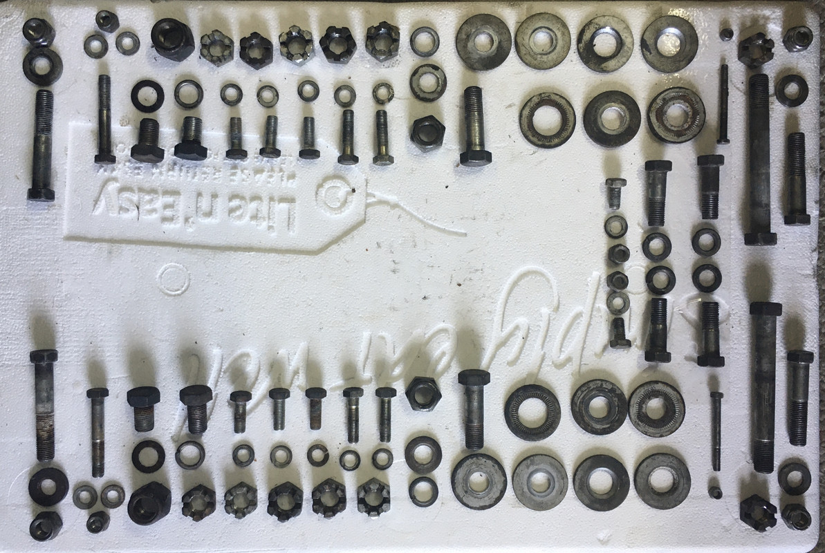

One tip I would give is to photograph the entire set of parts together, including washers etc. , before you send them to a plater, and give the plater a copy of the photo - and do the same on collection - that way there can be no argument about what was delivered, or for that matter what is returned
