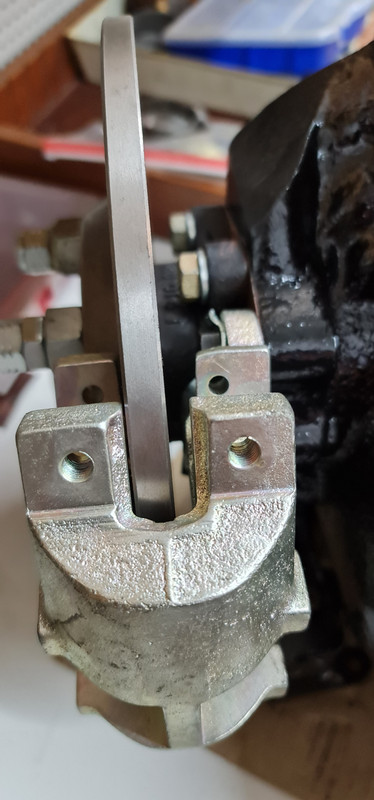

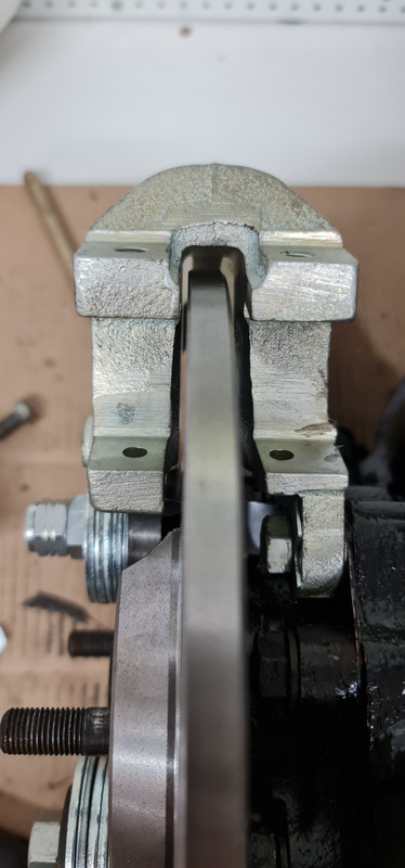

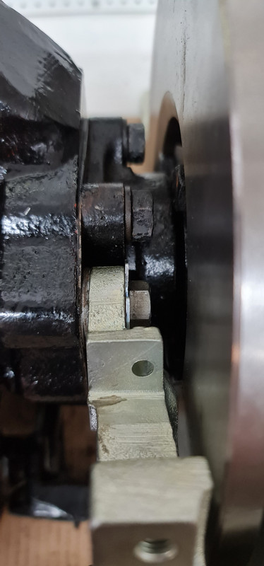

I should have read this before.
I am just about shimmimg my 61 and 62 rear brake calipers.
The outer caliper half was kissing the dome of the rotors and could not even turn. Hence I had to grind the corner off on both sides to ha e some clearance.

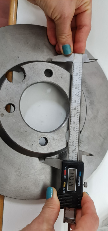

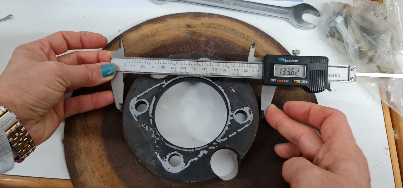

I noticed another thing with these aftermarket rotors.
They need more shimms to align.
The early cars do have the thin rotor and and the calipers with the thin bridge between the pads. There is not much to do wrong.
Only way to get everything straight is to use more shimms.
My rotors are Made in UK, does anyone has better experiences?
Maikel
