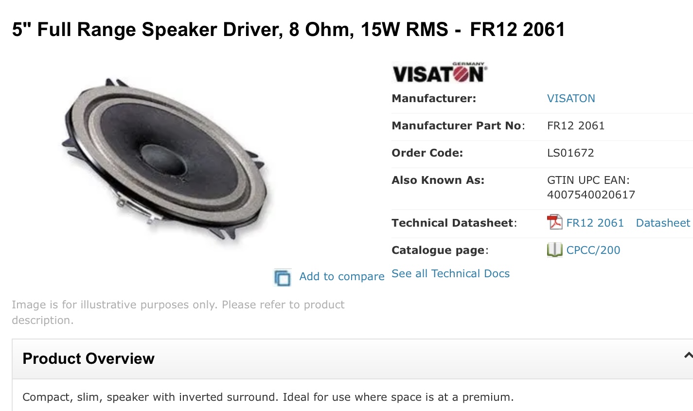

Posted: Sun May 02, 2021 7:31 am
by etype_F57
#16 Re: Original S1 Slim Console Speakers Wanted!
Posted: Sun May 02, 2021 12:09 pm
by mtnjag
Wow, incredibly cheap. Hard to believe the frequency response spec. Aren't they too big a diameter for you?

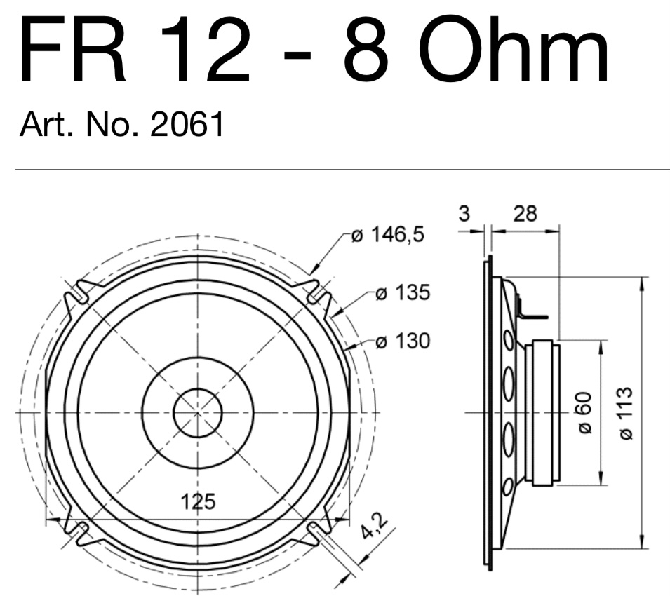

#19 Re: Original S1 Slim Console Speakers Wanted!
Posted: Wed May 12, 2021 7:46 pm
by ysmalkie
I found the dimensions of these Infinity speakers (Reference REF-6532ex):
I do not quite understand how they would fit - the diameter between the mounting studs for the original speaker grilles is 4.75".
The 6532ex speakers have a mounting stud diameter of 158mm - that's almost 6.25"!
You would have to drill the through the membrane to fit them....
Tadek
