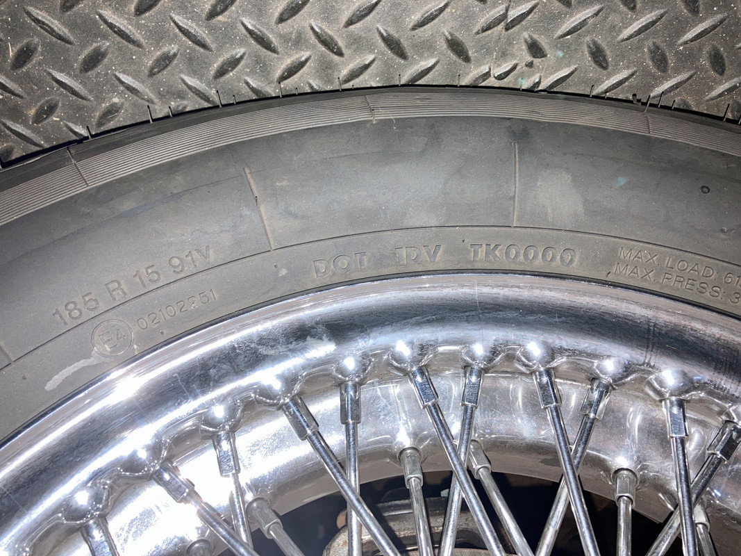

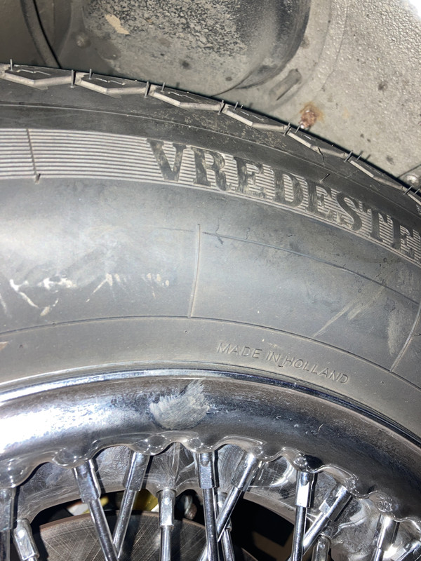

Post by rswaffie » Tue Apr 27, 2021 9:19 am
I have the Vredestein Sprint Classic 185 VR15 91V that are rated to 149mph. I got them delivered for £149 each.
They have a fairly plain, rounded sidewall which suits the chrome wires and looks nicely period I think. Probably not as ‘original’ looking as the the Cinturato’s, but they are twice the price.

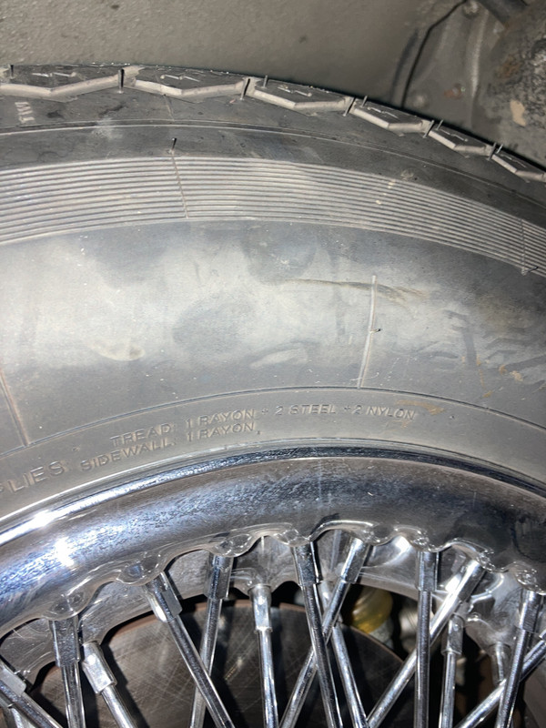

Richard ,
With the Vred's now having a V rating please could you let us know what is printed on the tyre sidewall re materials used and how many ply's are in the sidewall and tread , just interested as a comparison ,thanks

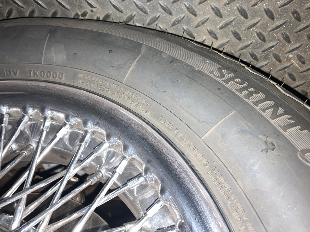

Post by rswaffie » Wed Apr 28, 2021 9:06 am
There’s a lot of writing on the wall!
Apart from the make and model already noted, this is most of the other info...
Enjoy.

Post by steve3.8 » Thu Apr 29, 2021 8:34 pm
Thanks Richard , Vredestein have added one ply of nylon to the tread to lift H to a V rating .
Steve3.8
