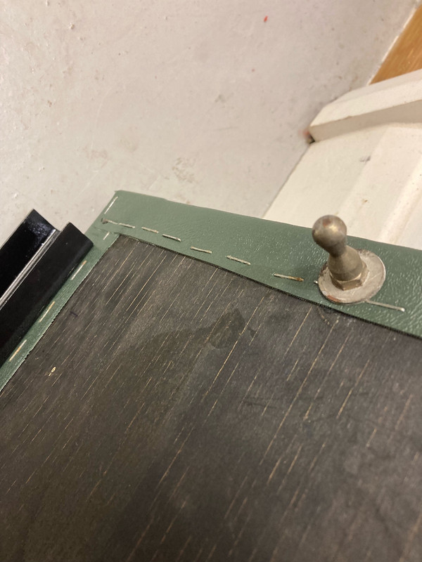

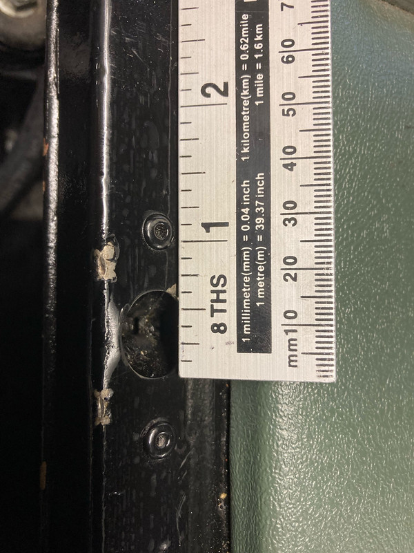

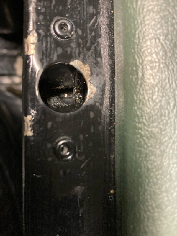

The two holes in the body cross frame are 5/8 inch diameter.
These holes allow the special shaped Stud, (BD.10958) fitted on both cover boards to pass through and for the round head on the Stud to lock into the clips below the hole. On my car these clips are riveted, but I’m unsure if that was how they were originally.

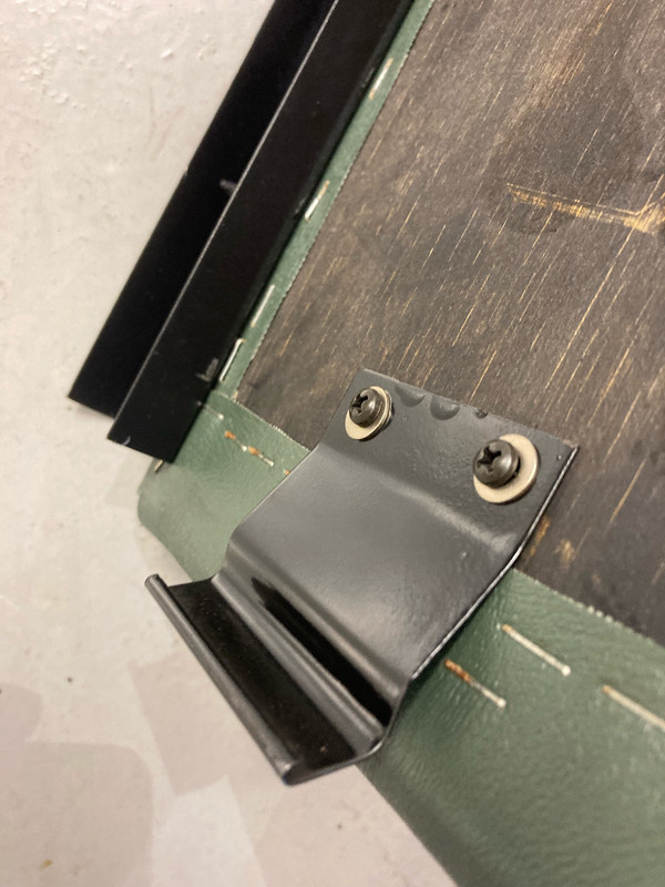

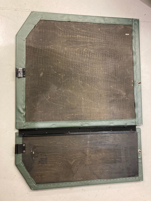

Both cover boards have the Spring Clip, (BD.28138) at the rear to engage with the body.
I attach some photos of the covers from my car which have been re-covered, but I believe use the original fittings. Looking at them, I need to sort out some of the paint chips on the cross frame in the winter lay up !
